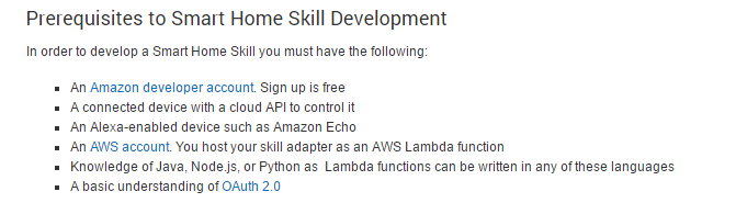

But do I have to buy Amazon Echo to use Alexa Skills Kit ?
Iâm not sure what you mean? Do you want to build your own echo (that is possible), otherwise Iâm not sure if using the skill kit would be worth while. Unless does it work on other Amazon devices?
I read the instruction and it said I must have amazon echo to use amazon skill kits
thatâs why I asked
Iâm now using raspberry pi 3, Oh2 and alexa via IFTTT as my voice controlling system. But Iâm quite annoyed whenever I want to turn on/off something, I have to say âAlexa trigger turn the light on/offâ which is pretty long. I want to get rid of the âtriggerâ word, just âAlexa, turn the light on/offâ will be very very awesome!
I encountered this post and itâs exactly what Iâm expecting! I hope you guys can help me install it!
@thete Speaking of âbuild your own echoâ, can you suggest me some links which show me how to build my own echo, please? Thatâs would be great!
I interpret âAn Alex-enabled device such as amazon Echoâ as any alexa device, not just the echo.
I.e Echo, Dot or "DIY alex with raspberry. "
Regards, S

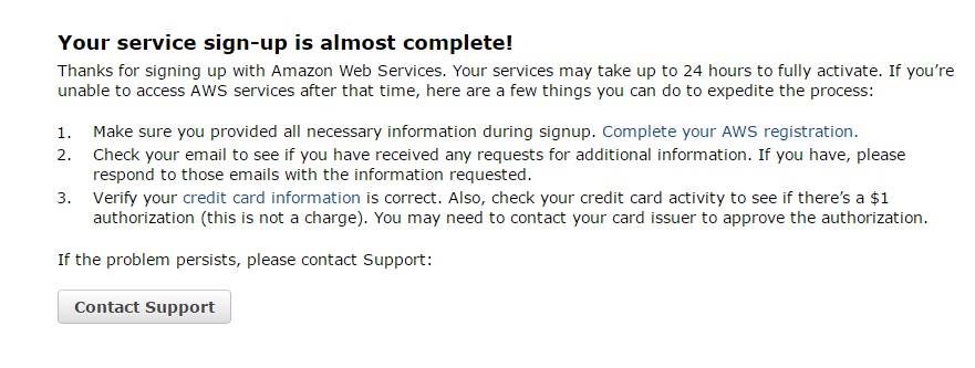

When Iâm registering, they ask for my credit card number. I donât have american express (neither Mastercard nor Visa - sorry Iâm just a high school student) so I use automatic credit card generator online : http://credit-card-generator.2-ee.com/
Is that OK? because Iâve been waiting from yesterday to now!
Again, thanks for replying!

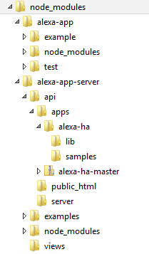

On top of this Iâm attempting to get it to work with OH2 (on a Pi) with Node.js hosted on IIS as thatâs currently occupying port 443 (and Iâm a MS guy at heart).
Iâve got node.js running with nodeiis as proved here: https://robpope.co.uk/node/helloworld/hello.js
After some fun and games Iâve installed alexa-ha, alexa-ha-server and request via npm, but Iâm not sure Iâve got the directory structure right.
Whereas most people are pointing their Alexa Skill at https:///alexa-ha/api Iâm not sure this is working for me as my api directory only has server.js inside it.
Any pointers would be greatly appreciated
Iâve now moved on a step. Iâd missed the very important step (being new to node it caught me by surprise) of running this from a command prompt:
node server.js
I can now access the test page by calling http://localhost:8080/alexa/Openhab-Alexa (not /api/Alexa-HA/ as Iâve changed the config file)
Now Iâm seeing that an invalid password is being supplied in the test. Baby stepsâŠ
I feel that Iâm close, but donât want to spam up this thread with my issues so will leave it at this.
I can now access the Alexa Tester page at https:///alexa/alexa/Alexa-HA
