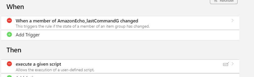

The openhab part is independent and is triggered by a change of a member of the lastVoiceCommand-Items-Group.

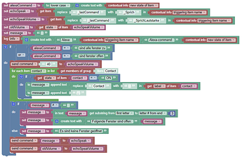

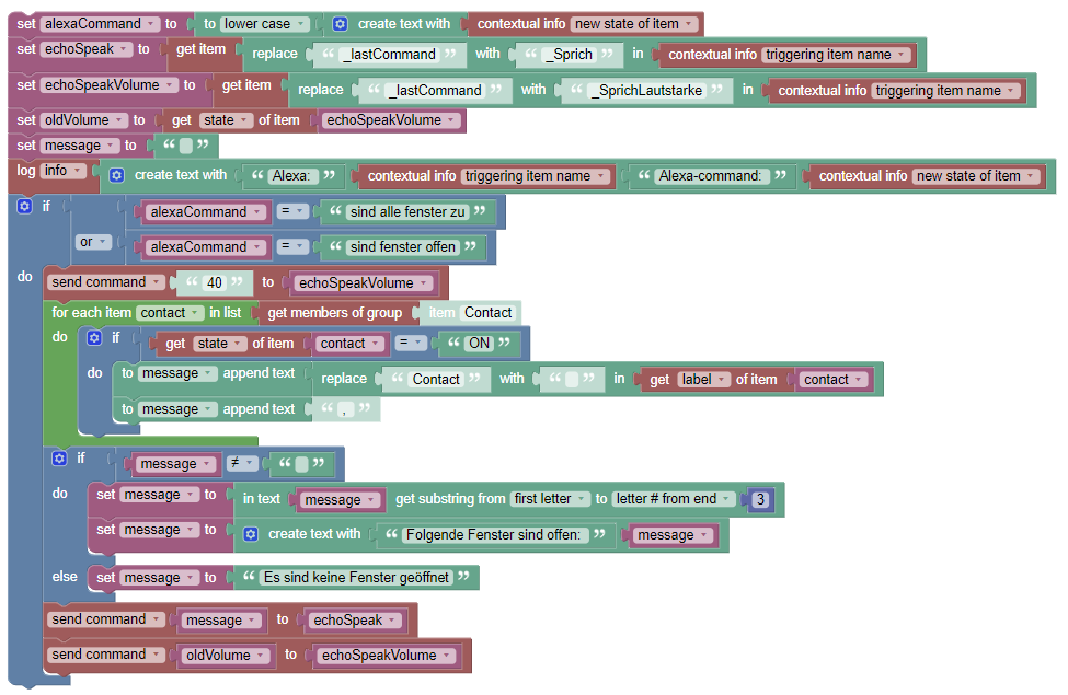

My use case is to ask if all windows are closed (“are all windows closed”, “are any windows open”). If any of my lastVoiceCommand-items (one for each Echo in the house) is changed to that command then openhab checks the windows and answers which are open.
This is the rule:
This is the action part of the rule:
