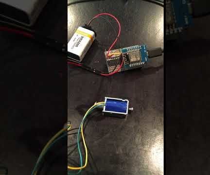

I remembered playing with wemos and alexa at the end of 2019 then disconnected because openhab was more responsive, since last voice comand is no longer seen by openhab I tried to turn wemos back on and it works, on wemos I only have 6 commands, and they work but they are not as fast as last voice comand I’m not very experienced but I modified this a bit for my needs
from what i understand it is because belkin simulation code still works
