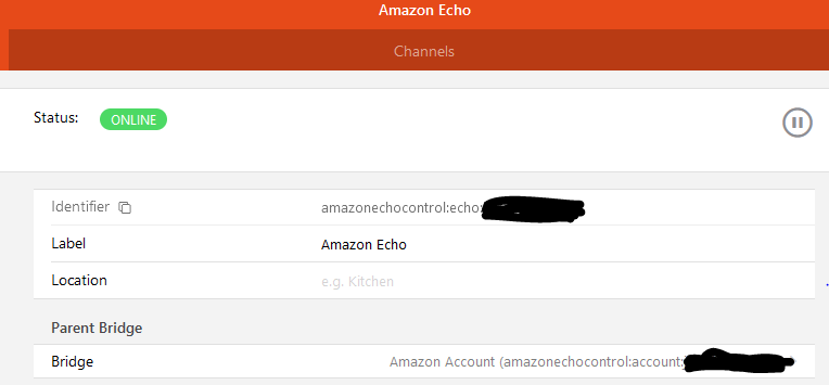

I created the rule as indicated
but this is what I get back (see below). Did I make a mistake?
Thanks for your help.
2023-09-21 11:17:42.088 [INFO ] [re.model.script.Echo, serialNumber: ] - Amazon Echo Control
Amazon Echo Control
Amazon Account
“xxxxxxxxxx” is mi account id
You can try to see what the source of the problem is. You could start by checking if you have access to:
http://openhab:8080/amazonechocontrol/account1/PROXY/api/activities?startTime=&size=1&offset=1
you can replace “openhab:8080” by the ip where OH is running, for example in my case it is:
http://192.168.1.19:8080/amazonechocontrol/account1/PROXY/api/activities?startTime=&size=1&offset=1
If you have multiple accounts, you may also have to change “account1” to the appropriate account.
When I put that address in a browser I get something like this:
{“activities”:[{“_disambiguationId”:null,“activityStatus”:“SUCCESS”,“creationTimestamp”:1695313282996,“description”:"{"summary":" play music","firstUtteranceId":"A1…
See https://www.openhab.org/addons/bindings/amazonechocontrol/ for more details on how to set up the “Amazon Echo Control Binding” if you have problems with the above.
On the other hand, for the rule to work you need to have the “JSONPath Transformation” installed in the OH additions.
Thanks, I didn’t enter the correct account. Everything works very well now.
