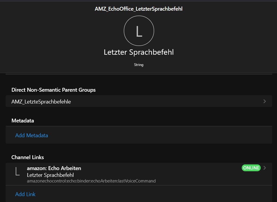

I’m running OH5.0.1 on docker with the core “Amazon Echo Control Binding”.
I upgraded to OH5.0 since it was released and it did not work, also now on 5.0.1.
I do get both: 429 and 503 errors from Alexa API, mostly 429: too many requests.
sometimes it comes through, but most of the cases it doesn’t. I do not use some kind of “trigger”, but an item linked to the corresponding lastVoiceCommand-channel. There’s no visible change since the upgrade von 4.3 to 5.

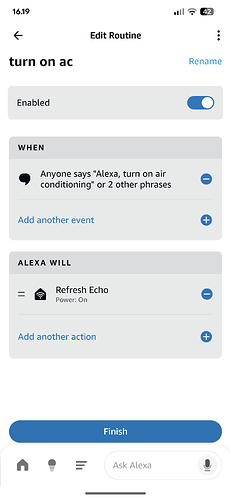

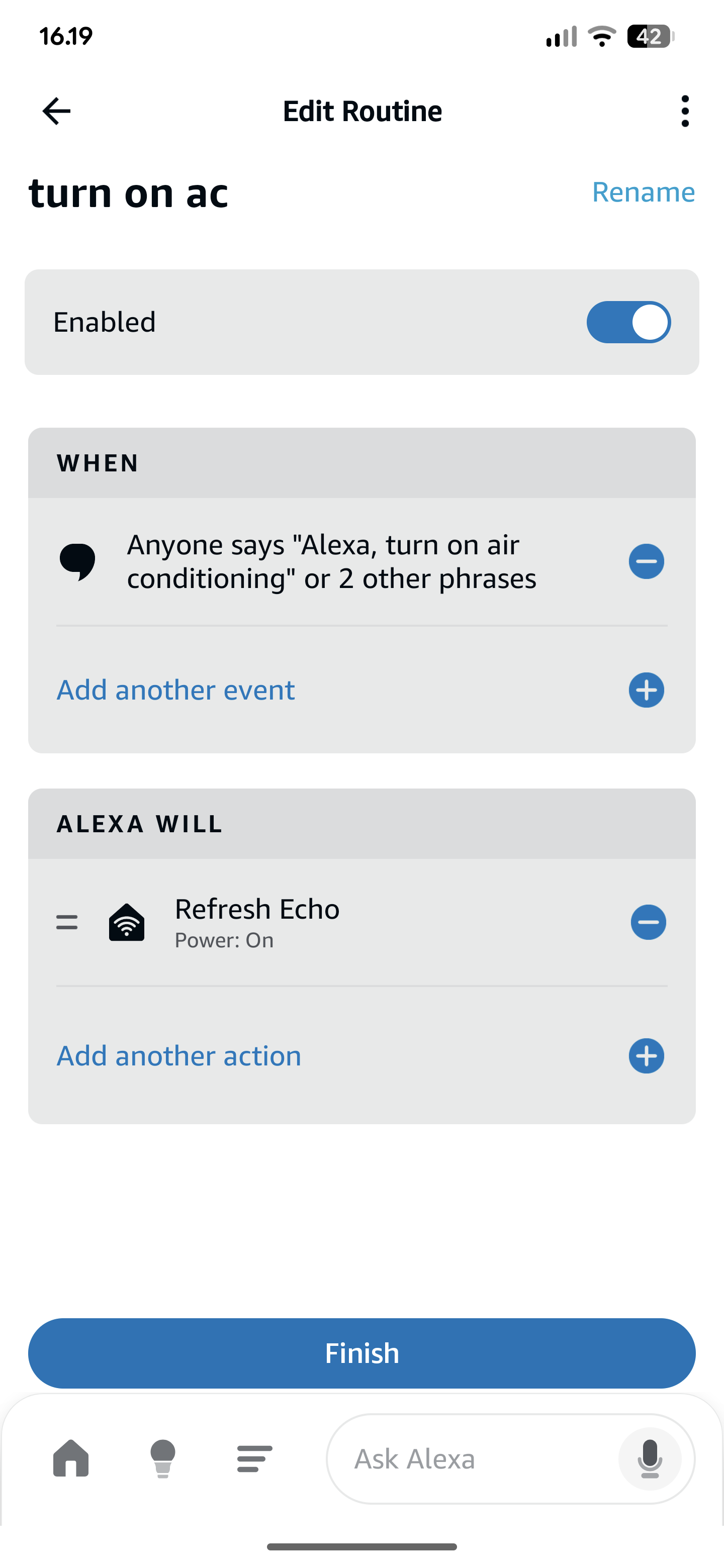

I trigger the refresh channel at the end of Alexa routines like this.
thanks, that’s the same way that I’m doing it. Overall it’s working pretty fine now.
@binderth : I don’t think you will get reliable lastVoiceCommands without using the refresh channel.
