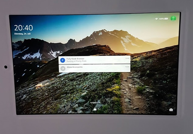

are you running the “with ads” version of FireOS? I just installed 2 Fire HD 10 woth Fully and configured motion detection to wake the devices, when I walk by.
The only disadvantage I have is that they only activate to the “ads” screen and do not open Fully directly. I have to swipe the ad in order to get access to Fully/Habpanel.
Any idea how to solve this?

Thanks for your replies. In the meantime I asked Amazon support to remove the ads screen, what they did. But they charged my the diff I saved earlier.
Unfortunately FBK still isnt able to get around the lock screen. Looks like this atm:
In case anyone knows how to get around this, I would appreciate the input.

Hey,
Yeah, the problems are all solved and the setup is running quite nicely for a year now. Iirc rooting the device did the trick which then gave the ablility to set some permissions and configs. Paying Amazon to remove the ads didnt do anything and can be done on a rooted device as well.

So you mean rooting on a fire tablet WITH ads would bring the same result?
Thanks for your fedback - I really appreciate it.
Yeah, I bought the cheaper version with ads. Then root it in order to remove the ads as well as as the locked in welcome screen.
