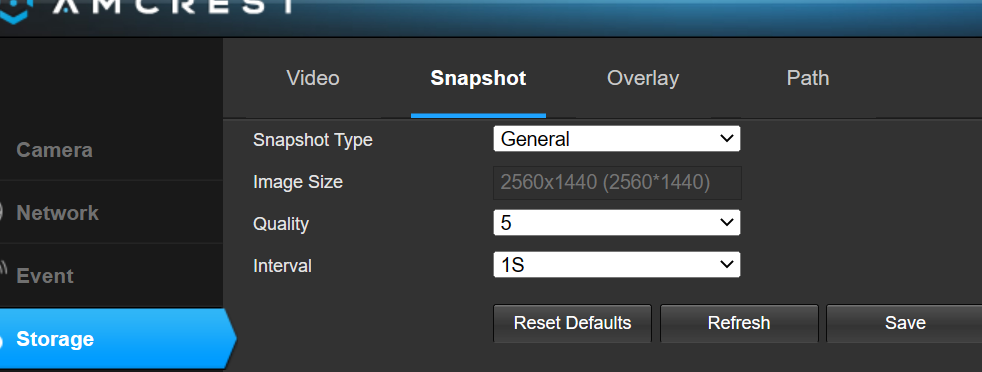

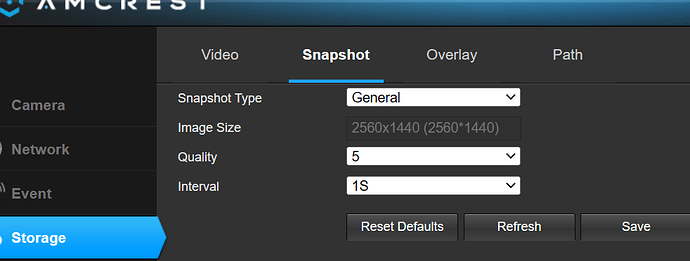

Set camera to take snapshots at 1 second intervals.

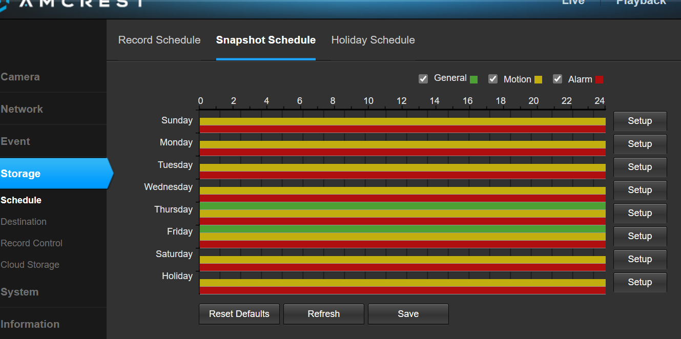

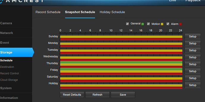

Setup the schedule to always be able to take snapshots, Note there is no green here so only when an alarm goes off the snapshots are set to be taken at 1 second intervals.

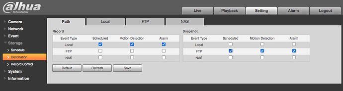

This step also needs to be done, you need to supply a destination for the snapshots, I have tried both FTP and NAS boxes ticked and they both work. You can have the nas/ftp disabled on the next TAB page so they don’t get sent, however it only works if you tick a box here.

Funny thing is, even without the green bar (no schedule for “General”), it still writes snapshots every second to the destination for “Scheduled”, if it exists. This is either strange or I do not understand it.
Since I do have configured a NAS, I have set the destination for “Scheduled” to SD card, which I don’t have.

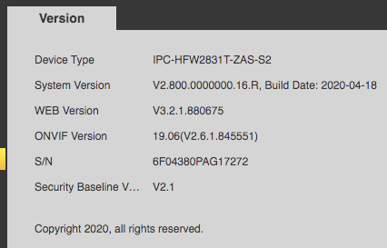

For anyone who finds this. I’ve confirmed this also works for Dahua Cameras (at least the version shown). Note: There’s an odd caveat with this firmware, when selecting the storage destination for Snapshots, it will not let you mix and match between NAS,FTP, or Local. It’s all one or the other. This camera has a SD card, so I set it to a non enabled/existent FTP server.

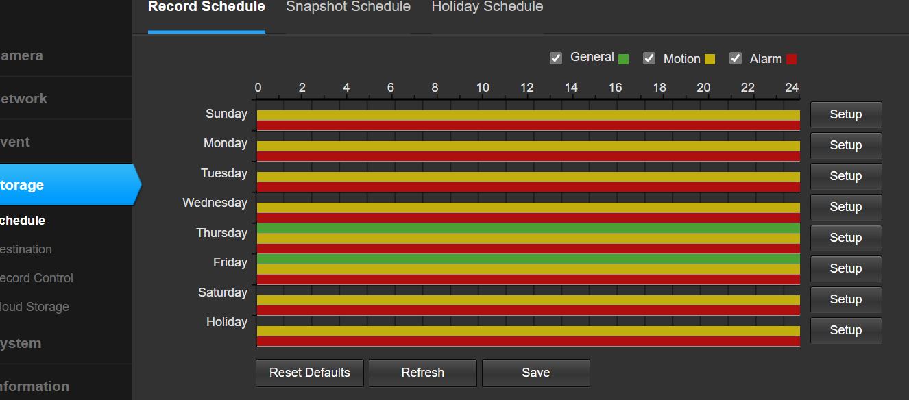

I found this thread while trying to troubleshoot a newly acquired Amcrest IP4M-4051.
I have the snapshot frequency set to 1s, the General schedule enabled, and I have ticked a box for FTP for the snapshot. But I’m still getting the 500 server error.

Your middle picture is of the RECORD schedule, you need to setup the SNAPSHOT Schedule which is the next tab over. You will have to experiment to find what works but if you are only getting the 500 error when a snapshot is requested then this will be the reason why.
The log you have posted is showing 3 of what I expect is 4 requests for a snapshot. With DIGEST auth, you will see the request happen twice for each snapshot. You can see the snapshot is requested 5 seconds apart, then the error 500 occurs 5 seconds apart as well.

I had also set the Snapshot schedule, but provided the wrong screenshot.
