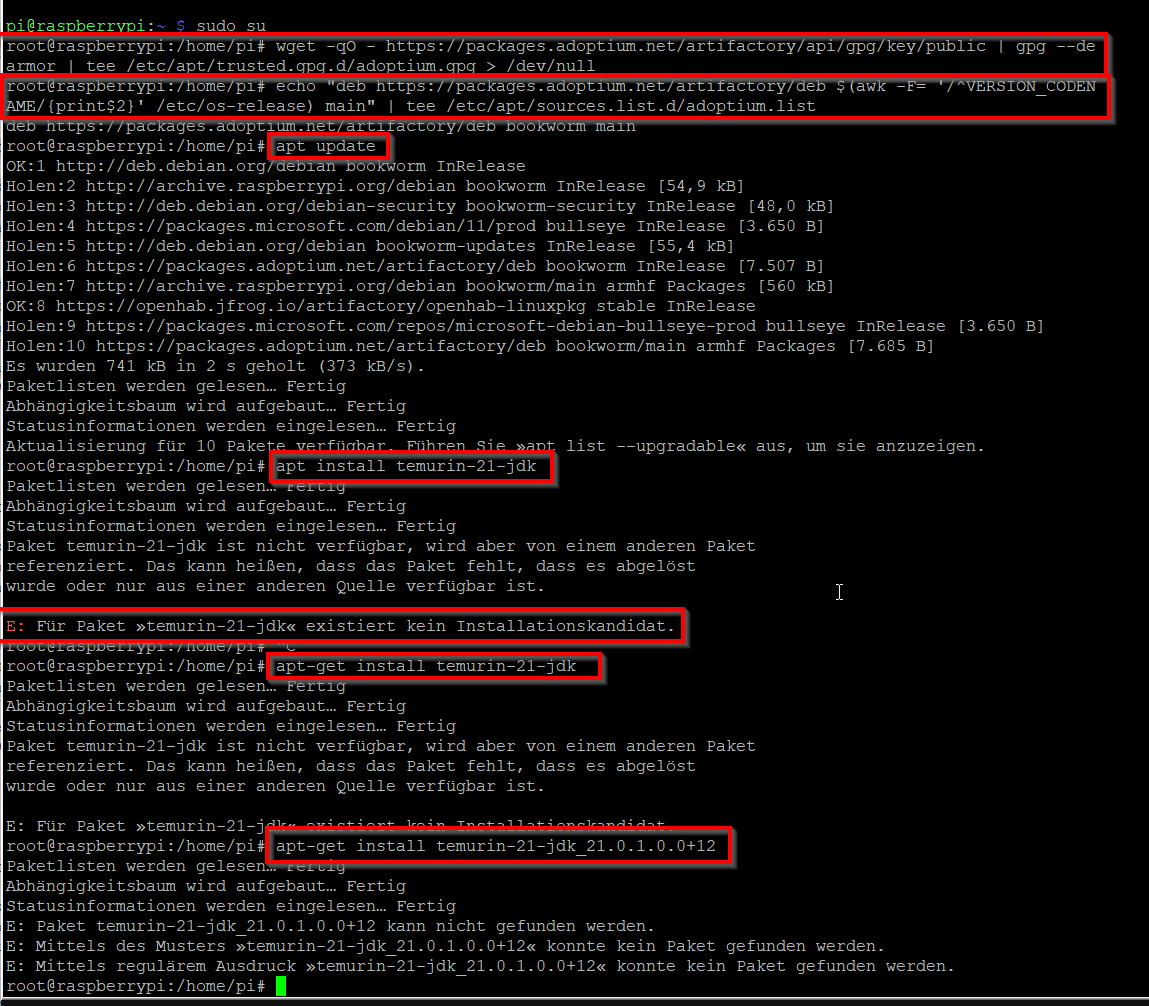

maybe, the recommend java for linux is Temurin but it’s not possible to install.

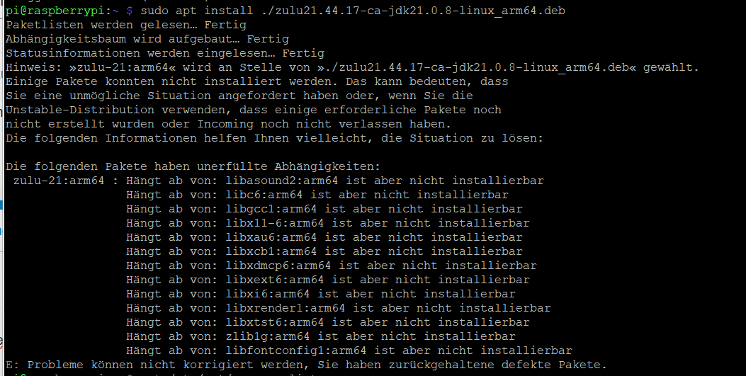

I tried to install Zulu but there are also problems.
I download the package like described on the zulu side but if I start the installation I get this error messages.
I use the fix
but same result.

The most likely problem is that you have a 32 bit OS installed, where Java21 is only available for a 64 bit OS. See also this topic.
The fact that the adoptium repository you added is showing “armhf” is giving this away, together with the later post of trying to install zulu, where apt is complaining that the arm64 libraries are unavailable.
You need to do an upgrade of your OS to 64 bit, basically meaning a completely new OS installation. So take the time to document what you have installed and configured and do a new installation, where OpenHabian is most likely to be the best suited choice. It is questionable if there will ever be a 32 bit version for java21 available.
