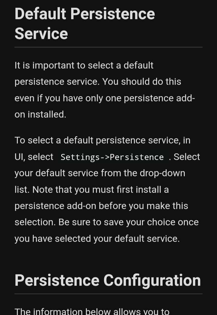

Is that about right? I was confused about this the other day too, and the documentation only says you should set a default, but not why.
Screenshot_20220106-122346
Yeah but I don’t want to use unessecary resources on items I don’t need persistence for. I’m afraid that’s my only solution though.

The docs makes it a little confusing and could be interpreted in different ways:
I can only speculate but I think its a choice in UI to make a persistence service work quick and easy without any file editing involved, but I don’t know…

I am pretty sure I addressed this in the Getting Started Docs. The default strategy for each add-on is (at least for the ones I spot checked) documented in that add-on’s docs. I believe this was also included in the 3.0 announcements. The Persistence documentation page states:
openHAB ships with rrdj4 as the default persistence database and comes with a default persistence strategy of everyChange, everyMinute, and restoreOnStartup for every supported Item. The good thing about rrd4j is that the database never grows beyond a given size, so you never have to clean it up. However, the way it achieves this (replacing ten readings with the average of the ten readings as the data gets older) makes the database not work for all Item types. If you need to restoreOnStartup unsupported Item types, MapDB might be a better choice for you.
This “default strategy” would be good to know. I’ve looked at the JDBC docs page, and nothing is mentioned there, for example.
OK - I looked in the Persistence docs within Configuration, not Getting Started. I view the Getting Started as “Welcome to OH3, here’s how to get started”.
I can’t find that in the Persistence documentation. I can see that there are two pages called Persistence in the docs. Because I only care about configuring persistence, I looked in the Configuration section.
Appreciate your response on this. It’s certainly clearer for me, except for what the “default strategy” actually is for each service.
Please file an issue. It should be documented there and for each persistence add-on. It is for rrd4j and mapdb (though MapDB seems to be missing at the moment???). It should be for all of the persistence add-ons.
Given how much has changed, everyone should look through the Getting Started. So so many threads from experienced 2.x users would not have been needed if everyone would give even just a cursory look through Getting Started.
It also helps to tie together a lot of these new features in OH. “Why did they do that?!” is often answered when you see it explained end to end. For example, why does OH 3 come with rrd4j with a save everything strategy by default? So beginners are not surprised when their charts don’t work because they neglected to go configure something from scratch.
