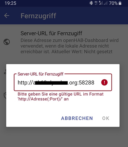

Can you provide some screenshot? Maybe with the url blurred for security reasons

Thank you for the fast answer
No, no special german letters
It is actually a beta.2.10.17-beta from 28.11.2019
But I work with it for a few days. It was with the update my previous URL easily adopted.
Only a new URL does not work.

Http not working for remote connections is intentional … see https://github.com/openhab/openhab-android/pull/1648 and https://github.com/openhab/openhab-android/issues/1624 … just the error message seems buggy, it should say https, not http. This seems like an error in the German translation.
I updated the translation.
