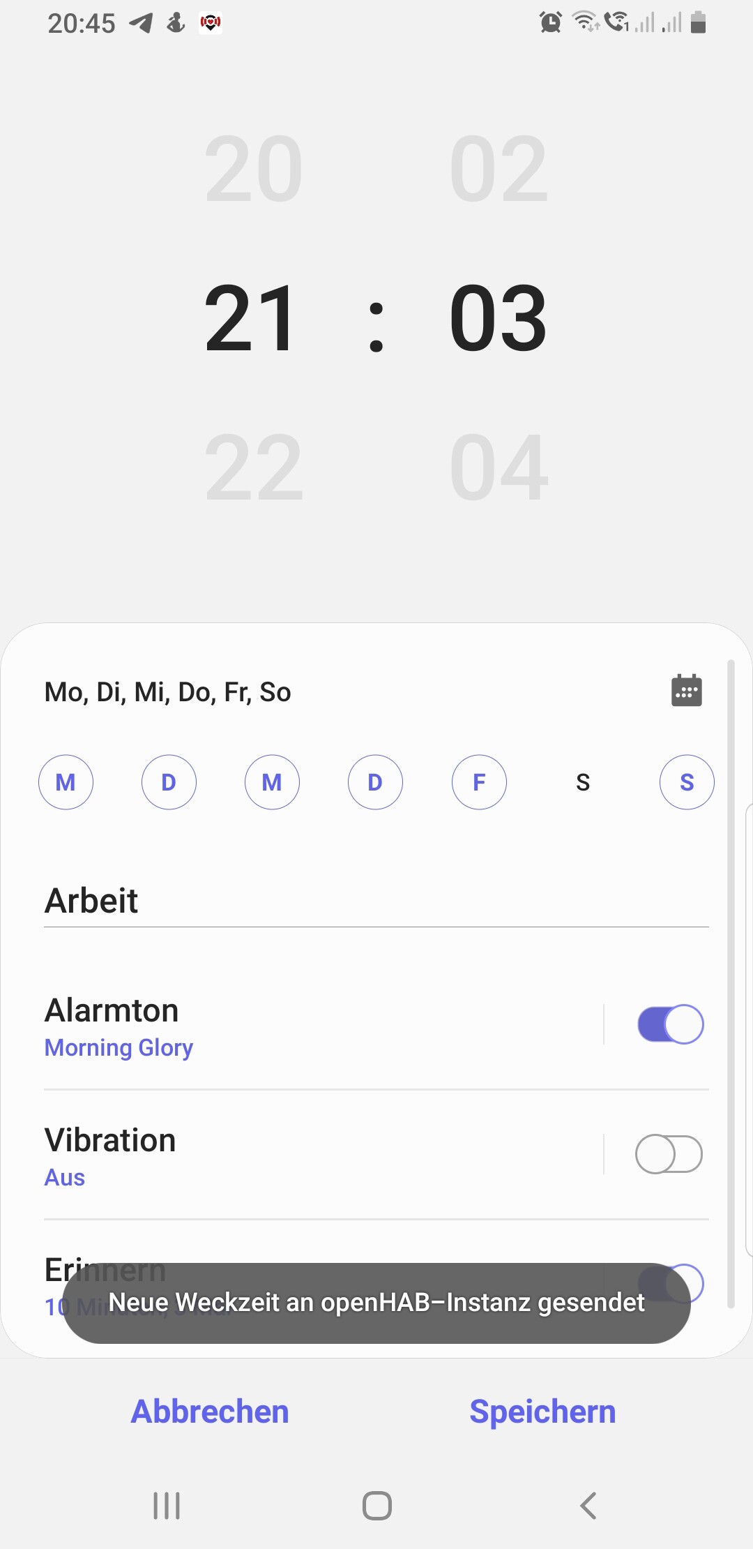

does anyone have the error that is sent in the time to Openhab is an offset of about 5min (299 seconds)?
Now and then comes the right value.
And if I set an alarm in the next 5 minutes, the time will be sent for the next week.
Screenshot_20190505-204510_Clock%5B1%5D
The log file contains the following:
2019-05-05 20:44:56.881 [vent.ItemStateChangedEvent] - AndroidAlarm changed from 1557082621 to 1557082681
This UNIX number converted: 1557082681 corresponds to: Sunday, 2019-05-05 18:58:01 UTC
exactly 4:59min to early.
And then exactly 5min before the alarm, the app changes to the right UNIX time.
Why? What am I doing wrong?
2019-05-05 20:58:00.556 [vent.ItemStateChangedEvent] - AndroidAlarm changed from 1557082681 to 1557082980
You likely do not do anything wrong. My guess is that your alarm clock app does weird stuff. The OH app uses this API whose return value is what was previously set by the alarm clock app via this API … so I’m pretty sure what’s reported equals what your alarm clock app is doing.
You are not doing anything wrong. I guess it is the alarm app: Wake up is “difficult” for an app, and there is no guarantee your app is woken up by the AlarmManager on time. So you schedule an alarm 5 min before you want to wakeup. The device awakes from deep sleep and sets an alarm in 5 minutes. As it takes some time for the device to go into sleep again, the next alarm will most certainly be on time.
