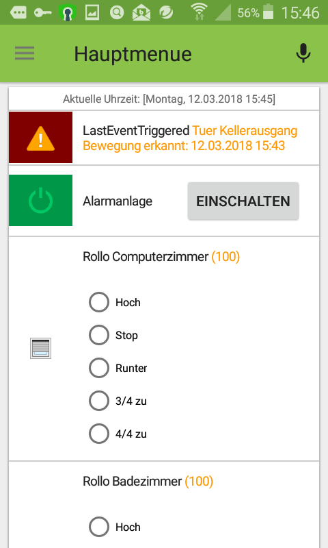

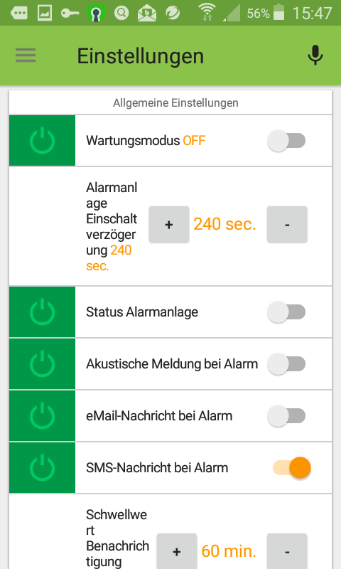

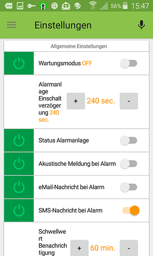

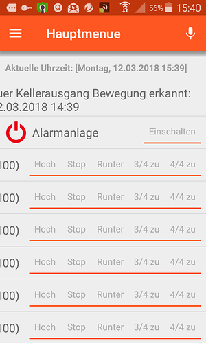

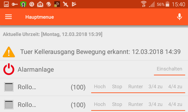

I tested it today. Is there a way to change fonts size? All my sitemaps are too big and not fully shown. Only in landscape view I can use it, but not all is shown too. See some examples below.
Portrait view:
Landscape view
I use 3Hou.se APP at the moment it this APP solved it in a good way. But has some other bugs. I use all two at the moment in parallel
