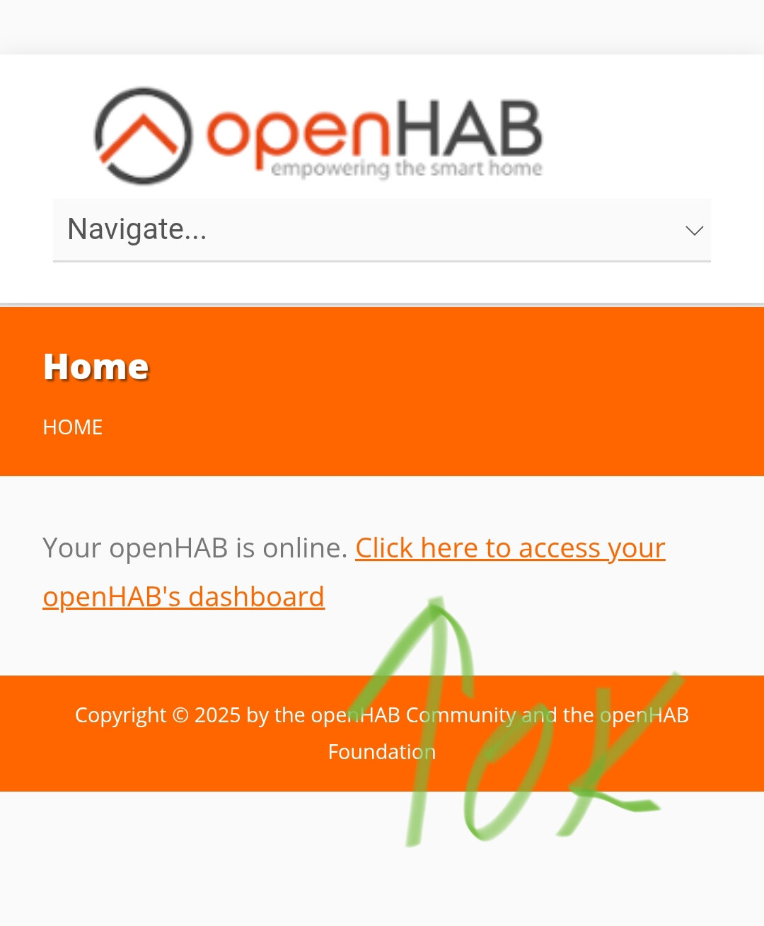

On myopenhab.org everything is also fine:

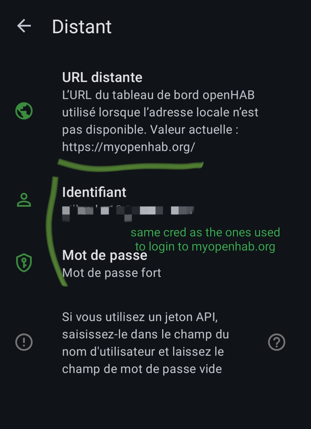

On the App side, I let the local setting “empty” and configured only the remote one:
So here my identification is == myopenhab.org. Is this setup correct?

For the remote connection through the openHAB Cloud Server, you use https://myopenhab.org/ as the URL and the credentials you use to log in to myopenhab.org as the username and password.

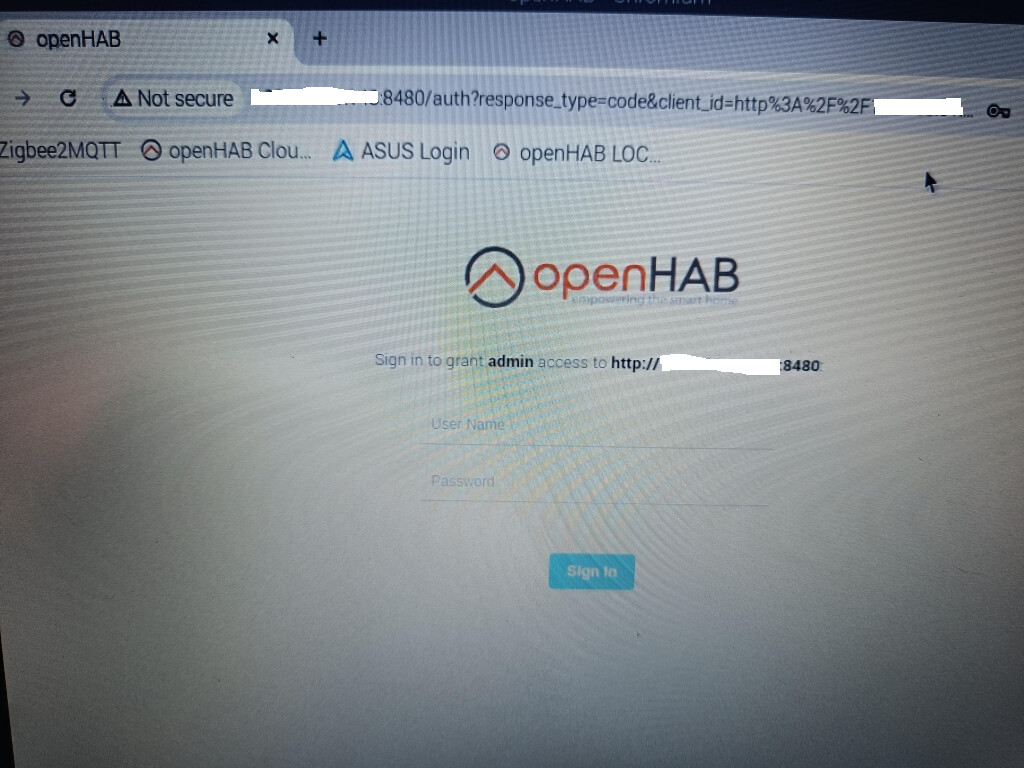

That is correct. Locally I have the admin auth available (remote display with my VNC client):

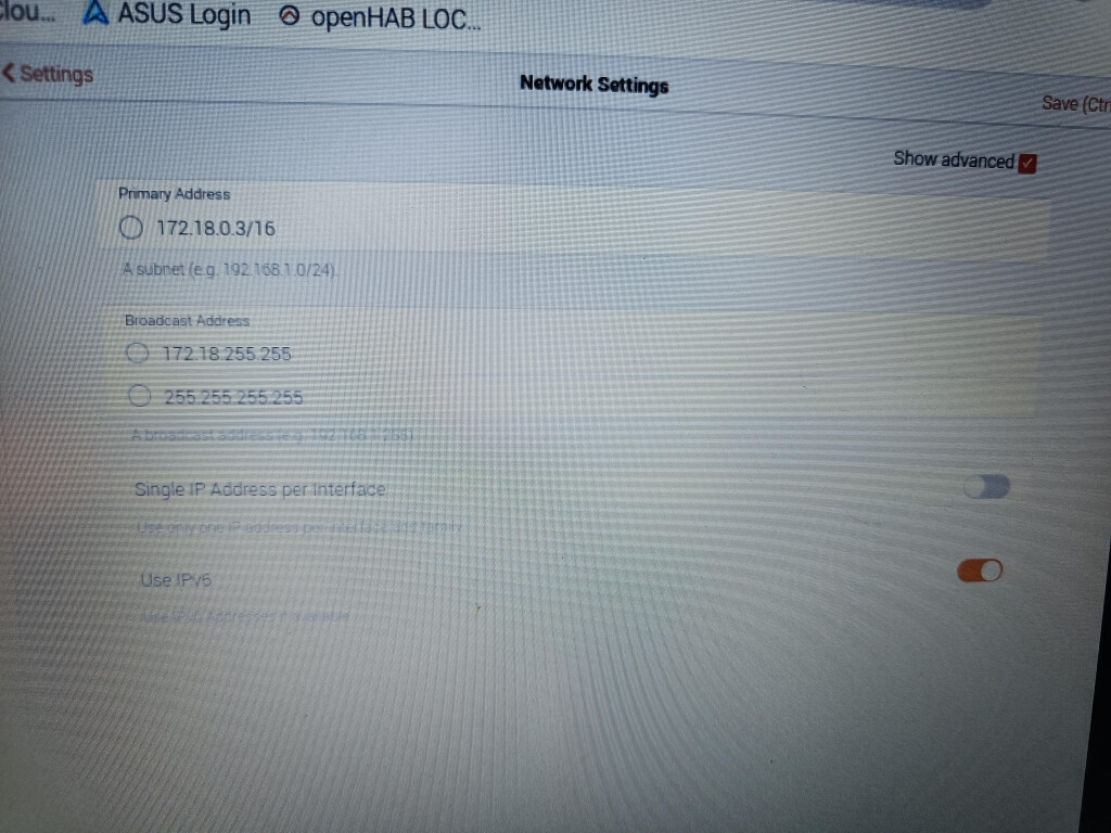

You can try going to Settings → Network Settings and make sure that the Primary Address and Broadcast Address seem reasonable. If it’s pointing to a 172.x.x.x IP range your OH might not be listening for incoming connection in the right place. Though I wouldn’t expect it to work using a browser in that case either.
sorry for the quality, somehow my VNC client does not permit screenshot somehow. But if I follow your reasoning right, the fact that I can access to my mainUI via myopenhab.org is the proof that nothing should collide with regards to the well-functioning of the App, right?
