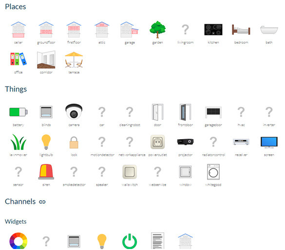

And also it is not shown here anymore:
Links to Docs → Iconsets
And there are a lot of question marks, too! Does it mean, they are not supported anymore?

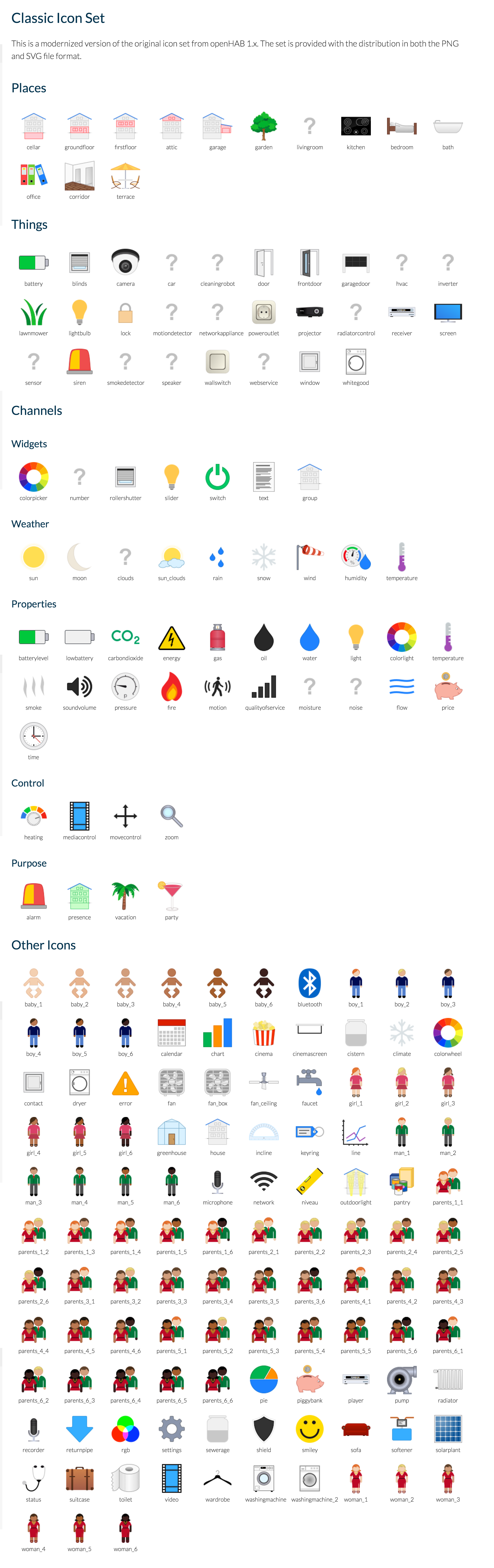

here is the reason:
master ← kaikreuzer:icons
opened 10:15PM - 18 Sep 17 UTC
This PR restructures the (icon) categories in a way that it better groups differ… ent category types (e.g. all locations, all "measurable properties", etc.) together. The goal of this is to work towards a better match to an ontology and to have a clean definition of which icons an icon set has to provide mandatorily.
The Classic Iconset page now looks like this:
The different category types are separated from each other. I have also removed the different states for the same icon in order to provide a better overview. The different available states are shown as a hover text:
<img width="266" alt="screen shot 2017-09-19 at 00 12 32" src="https://user-images.githubusercontent.com/3244965/30567144-47818322-9ccf-11e7-9b90-7b70be3dbbfa.png">
A future enhancement should be to replace this hover text by a pop up showing the real icons instead.
I mark this PR as API breaking as I have also removed and renamed certain categories, so that users might have to adapt their setups accordingly.
Signed-off-by: Kai Kreuzer <kai@openhab.org>
and here:
Link
Very interesting!
So I have to check my .sitemap and my .items for “expired icons”…
here are my results:
old name new name
Maybe there are even more?
The current icons you can find here: icons

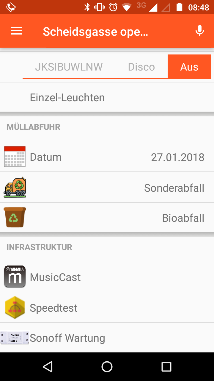

Is it possible to get your own icons visible in the Android & iOS app? I mean for me essential icons like “Kodi”, “iPhone”, “Netflix” etc. are missing…
Like this?
This should work, when you put them in the icons/classic folder from your configuration.
They have to be available in the format you configured the app to use.
I have not all of them in svg format now, so I switched to the PNG setting in the app for now.
Thanks, that helps! I need to set the icon type
