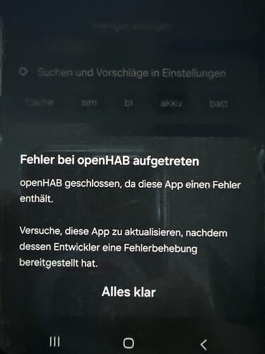

The android phone of my wife crashes when a notification arrives.
Any ideas how to debug this a bit more?
