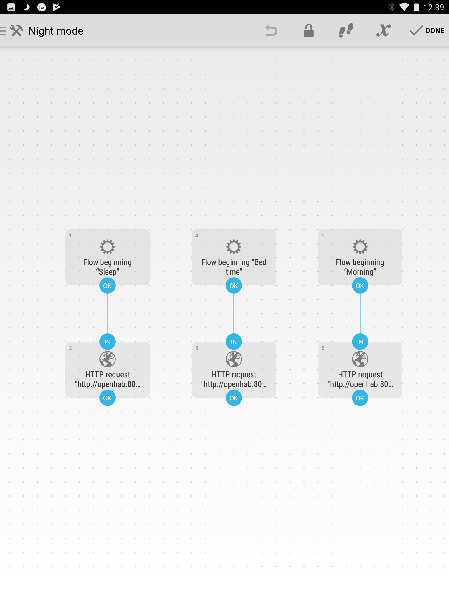

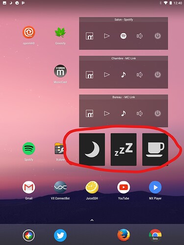

Just wanted to add that I’m using Automate, a free Tasker alternative on my tablet. I found it very capable. There’s a limit of the number of “blocks” running simultaneously then you have to buy the premium version (I didn’t reach the limit though). A good thing is, there are no ads even in the free version.
My needs were quite simple, I just wanted widgets on my home screen which the Android app doesn’t offer. I have configured it to send POST requests to the API like this:
Request URL: http://openhab:8080/rest/items/Scene_General
Method: POST
Request Content Type: Text
Request Content: 4 (or whatever)
Then this allowed me to add the following widgets:

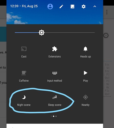

It can do notifications and quick settings too (among other things, I might try out the location or wiki block on my phone for presence detection):
