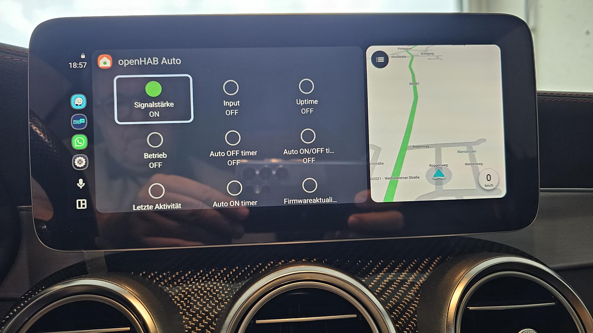

If I select a group item, all item from the thing are listed. But I Need only one, and the from different things

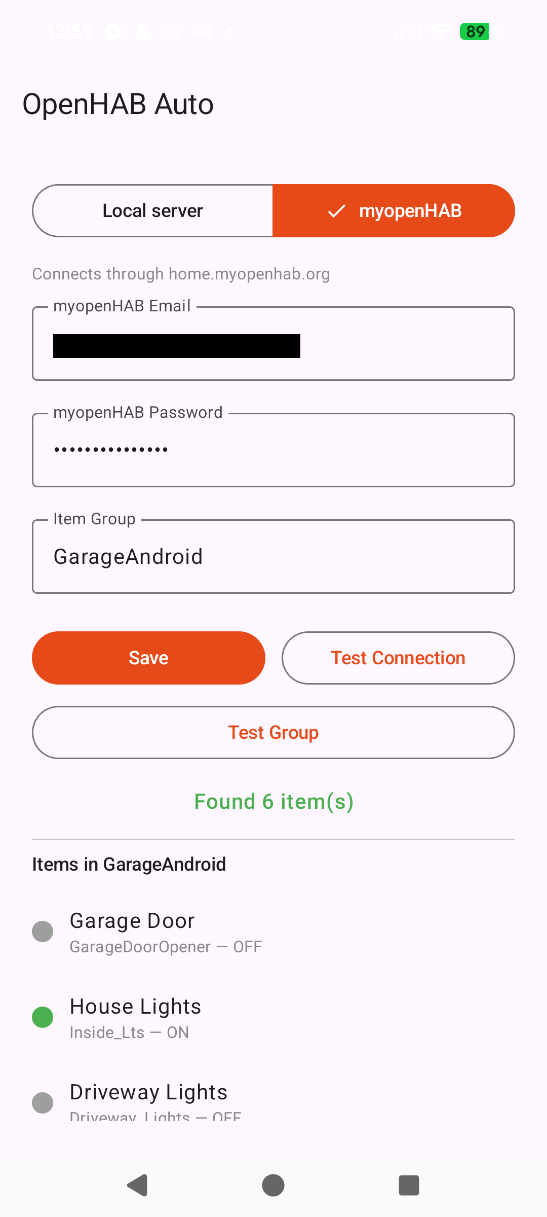

the phone has the settings, you can configure it for a local server URL or it can be used with https://myopenhab.org/. Then in openHAB make a group called “AndroidCar” or similar and put the switch items you want to show up. Put that group name in the app settings and click test to see if the items appear.

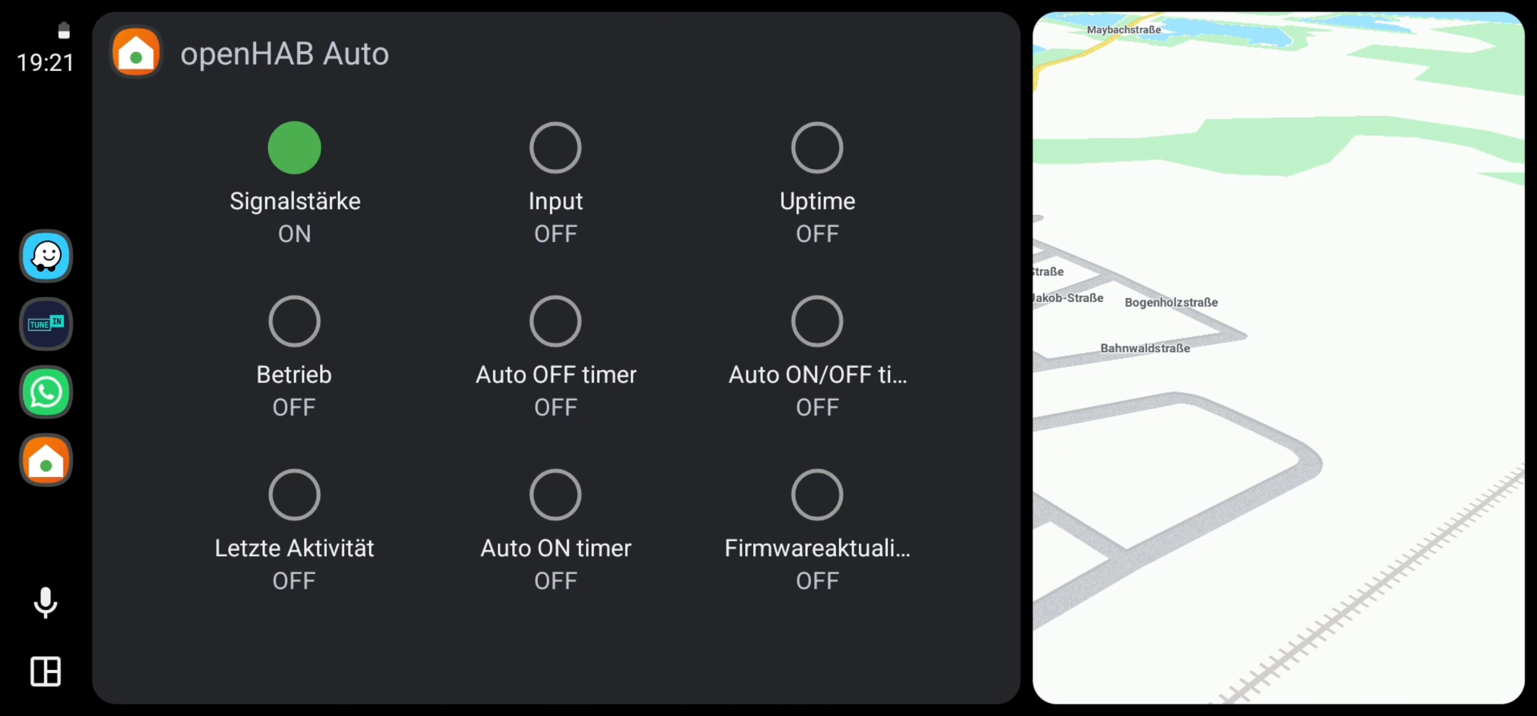

In the app preview the value is readable. In the car its only ON /OFF

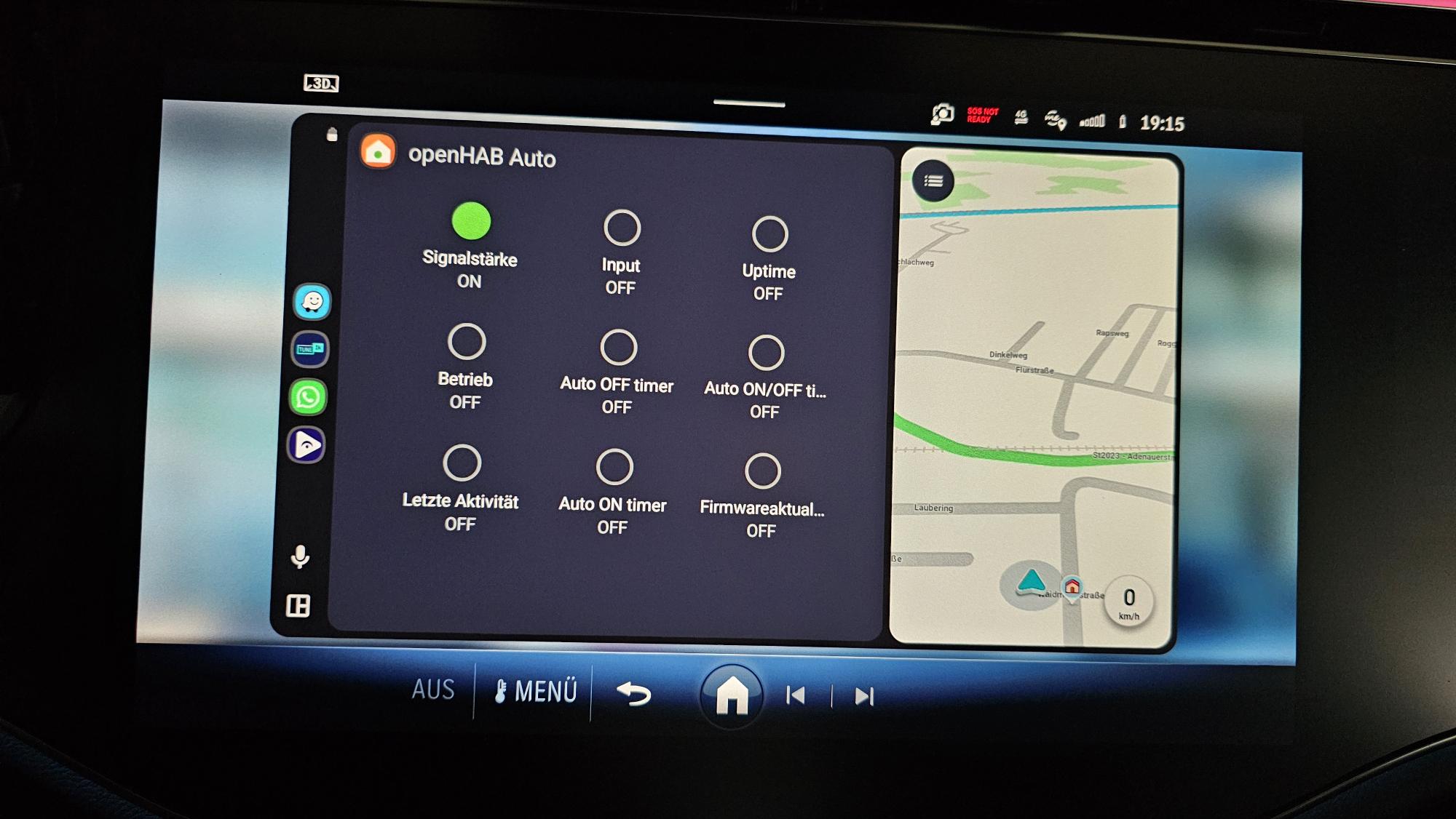

Some examples:
Polestar 3
Mercedes C-Class A205

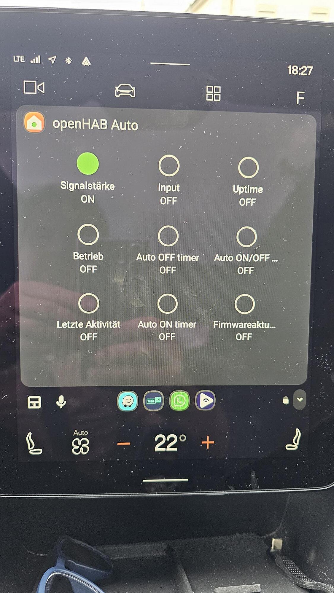

HeadUnit Emulator

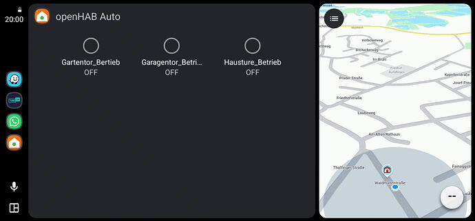

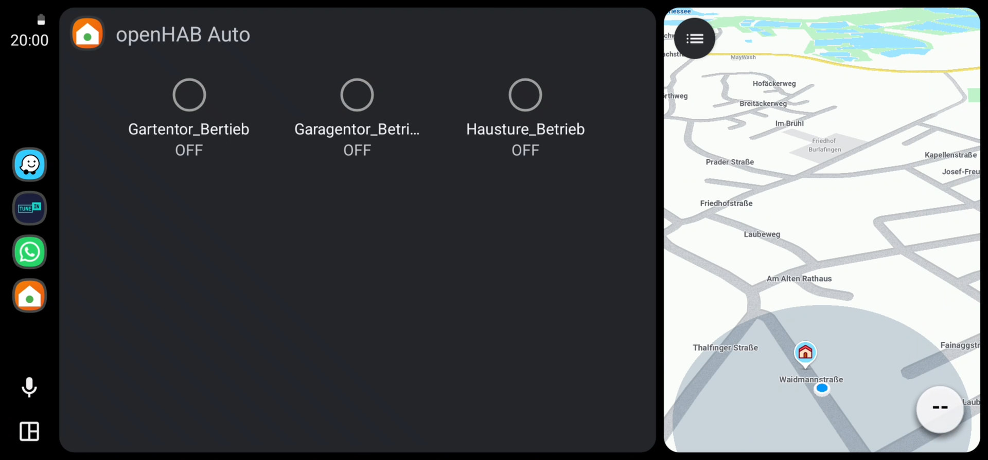

I generated now a new Group called “Android Auto”
Addtional I edit my three favorite Items, and added them addtional the new group “Android Auto”
I can list now in the App, the new group, and my three favorite Items are shown.
There was an need to give them a new “label” e.g. change from “Betrieb” to “Gartentor_Betrieb”
In principle in works, but I would love to stay the OH things, items, etc as they are from naming point of view, and only select them which I want to use from the app.

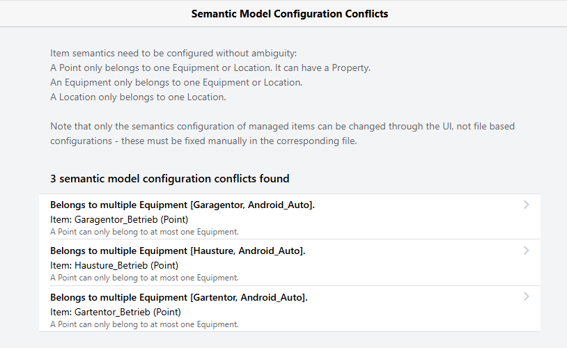

The Health check says now the following:
I have found now a new way, that the Semantic Model in not impacted.
So I created for each item which I need a new one under each channel and added this new item which the label which I want to have under the new group. I my case called Android_Auto.
So for me it works now as it should. And I have the Name that I want.

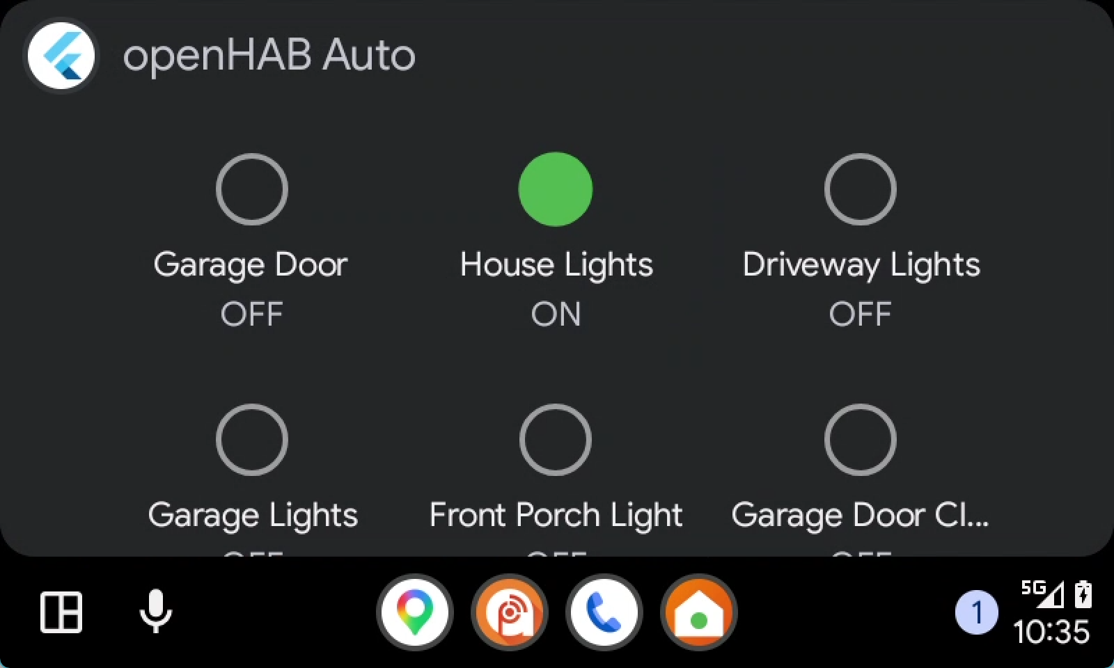

I released a new version(1.6) with most of the requested features. On the phone main screen you can now move items up and down to create a custom item order that will be used on the car screen. I added number Item support(read only ATM). For string items it will get the available commands and display a list to call them. I added support to change dimmer values, due to no native dimmer item in Android Auto it is just a list of redefined values to see. If you have any issues let me know.

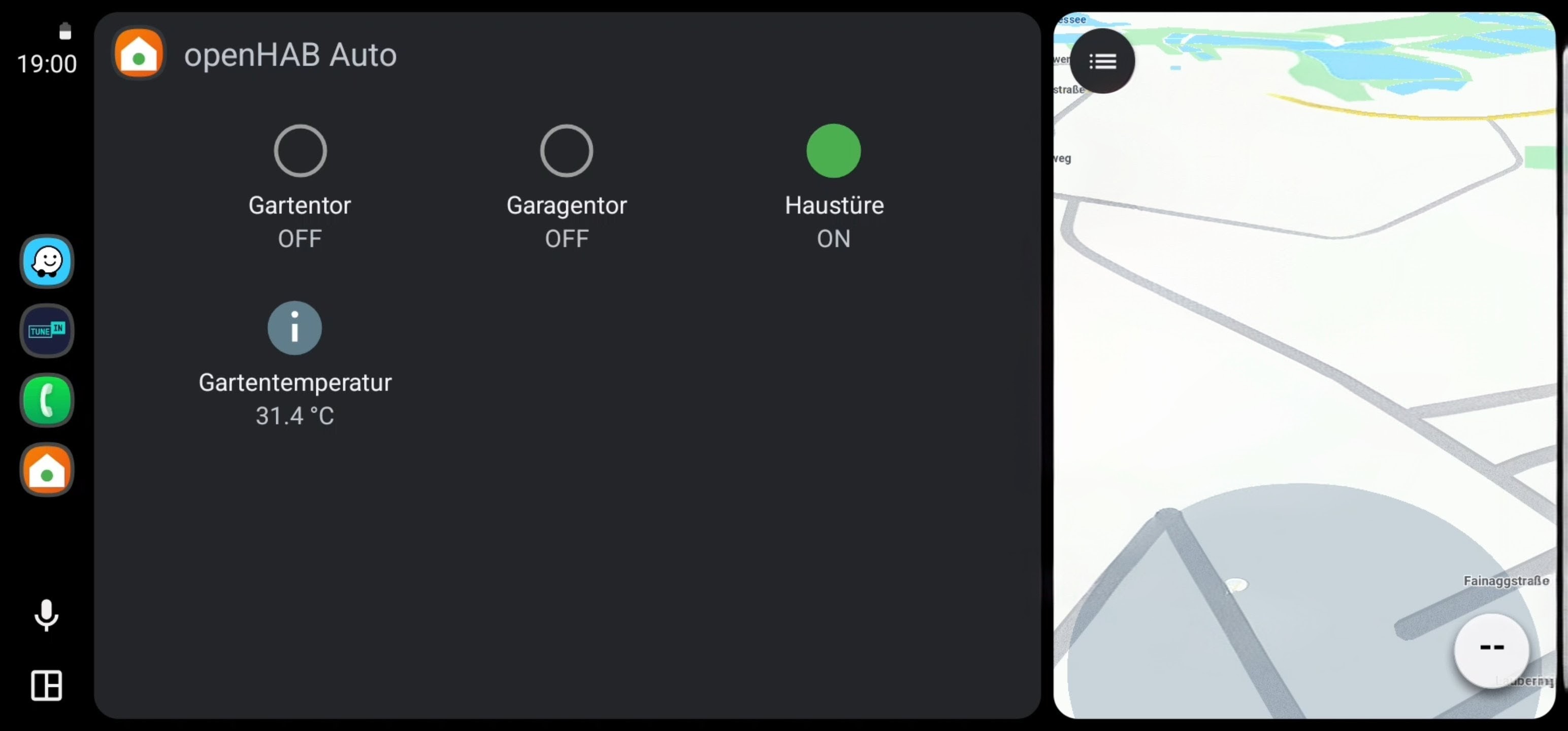

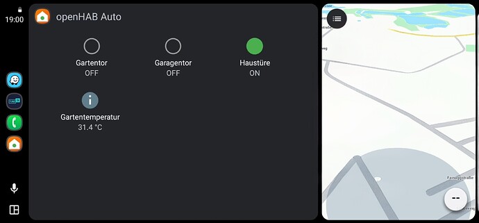

Wow, wow, wow…
Very, very nice. Arrangements from the icon works, as well as I have added a item with information about temperature in the Garden at home for an example.
Very cool…
See here the screenshot from Headunit Emulation App.

I must be missing something… I put my myopenhab credentials into the app. When I press “Test Connection” I get an error “Connection failed: HTTP 401”. I can access myopenhab successfully from a browser on my phone, so I don’t believe there’s a connectivity issue.
