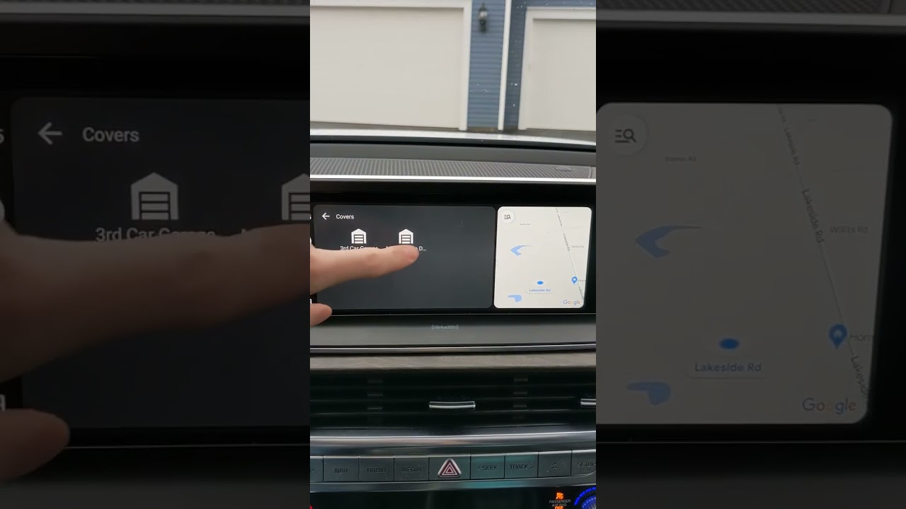

Here’s a video of Home Assistant in action on Android Auto. I found it at Home Assistant coming for your car! - Home Assistant
This would be the perfectly solution,if it would work also for Openhab….
