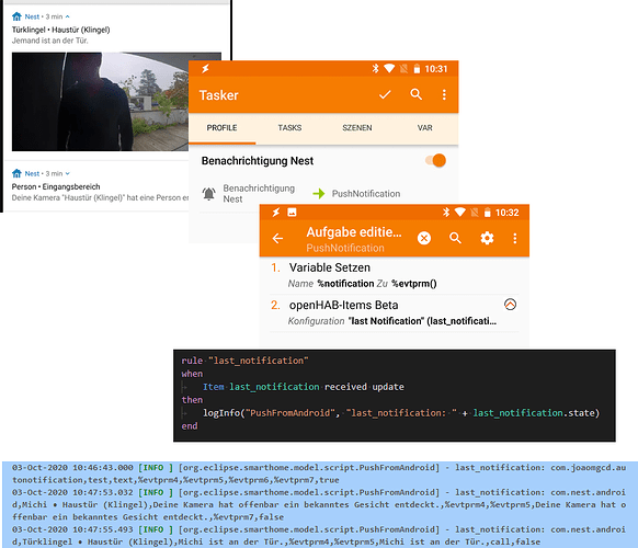

For example my nest-hello-doorbell has a good working face detection but no way to exchange the data with openhab.
My approach is to use an old smartphone as a notification-proxy.

Then I think it’s a hack at best. It’s ok to use if you cannot find a different method to query state but suboptimal in terms of architecture. Tasker, a smartphone to require G**gle services … lots of dependencies on external units.
Selecting proper devices (device with a proper API) is key in the first place. But even many legacy devices can be queried/polled in one way or another using HTTP binding or other or send a HW trigger (such as your doorbell’s electric signal).
