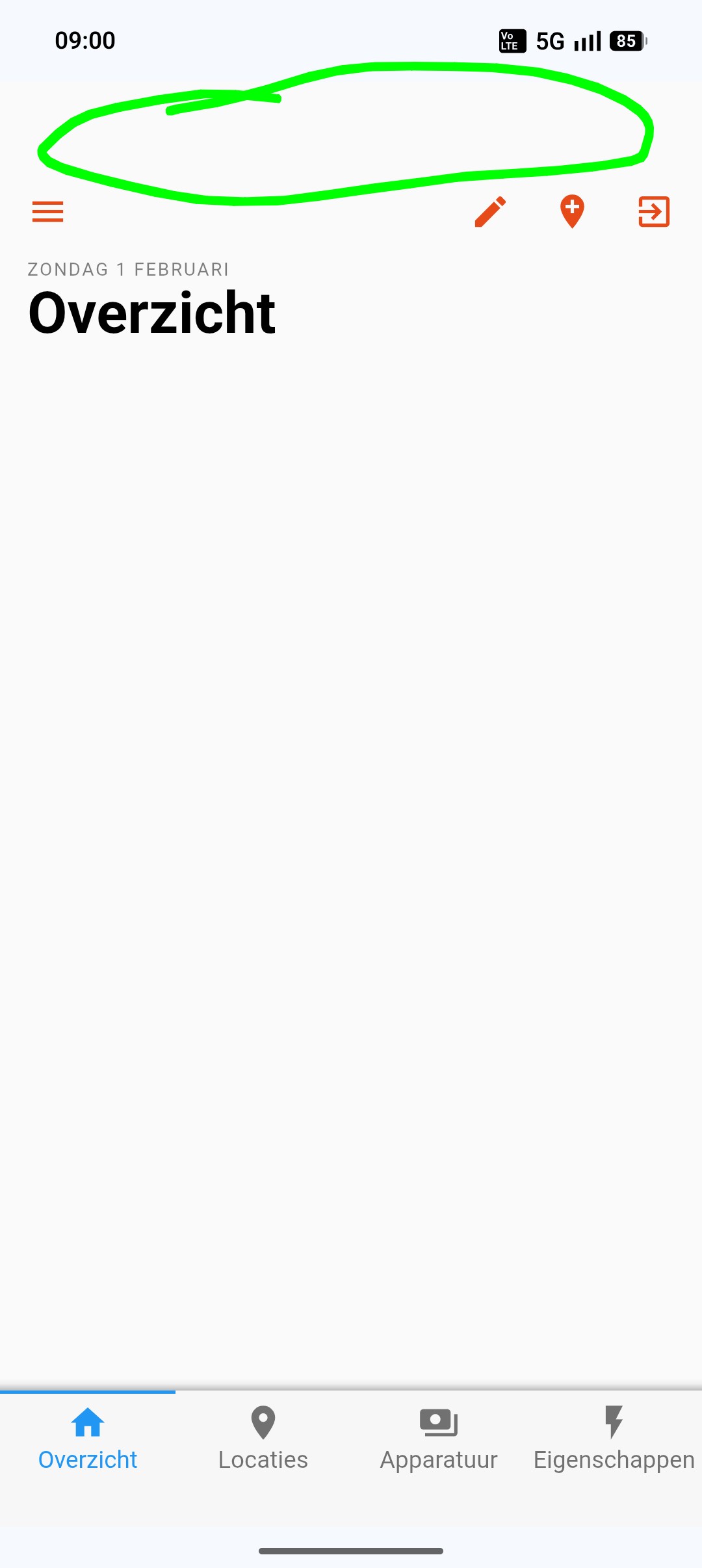

As seen on the screen shot below, the upper cm of my screen is unused. I don’t remember it being that way before…
Does anyone recognize this behavior?
It’s a change in new WebView versions and will be fixed in the next beta release of the app via this PR.

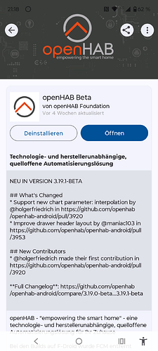

F-Droid does have the beta channel:
Some years ago the beta version was published as a second app, but Google removed it, because it was too similar to the stable version. You must publish beta releases via the beta channel they said (and still https://play.google.com/store/apps/details?id=com.chrome.beta …)
Some time later I started using the beta channel feature, but as putting beta releases on Play Store needs manual interaction, I only do this right before a new stable release.
F-Droid still has beta releases as second app and that’s fully automated.
