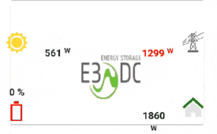

e3dc
The f7-row and f7-col components have a special property tag which lets you specify what element tag you want those components to be rendered with. If you want the animation to work with spans then you just need to have one f7-row (or anything else that makes an easy to use container) with the arrowleft class and then in that container you put three f7-row components that are each set to span:
- component: f7-row
    class: arrowleft
    default:
      - component: f7-row
          tag: span
      - component: f7-row
          tag: span
      - component: f7-row
          tag: span
The beauty behind the css is that it doesn’t really matter exactly what the elements are as long as you understand the structure of your page and know how to get the selector that you want. Instead of using spans, you could stick with the Label components that you got working before (div elements), you just have to have a container that has the class and contains three labels, and then change your selectors accordingly:
- component: f7-row
    class: arrowleft
    default:
      - component: Label
      - component: Label
      - component: Label
and
.arrowleft div {

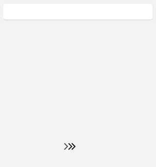

@JustinG Thanks agaín for your answer!
I tried your first Version but the animation with the other arrows is not shown…

animine
With your second idea i get this

animine2
In both cases, you’ve lost part of the original structure of the css code. Look back at what you first posted, the only styling that was applied to the container was the positional information (.arrow), all the rest was applied to the child spans (.arrow span) and then the delays were applied to specific children via the nth-child pseudoclass (.arrow span:nth-child ← note must use the colon which has also gone missing from your code at this point).
What you’ve posted here has most of the styling applied to the container, which was one of our first working models when we were only using one arrow, but now that you want to have multiple arrows, you have to make sure that you are applying the stylings at the correct level.
.arrowright {
  ... positional styles for the entire block of arrows, if you care
.arrowright span {
  ...how to turn every child span of arrowright into an arrow by turning it and drawing some of the box borders and then animate each arrow exactly the same way

I tried again with this:
uid: Test_widget_css
tags: []
timestamp: Mar 8, 2022, 10:33:31 AM
component: f7-card
  class:
    - display-flex
    - flex-direction-column
    - align-items-center
  content:
    - component: f7-block
        style:
          --f7-theme-color: var(--f7-text-color)
          display: flex
        stylesheet: >
          .arrowright {
             position: absolute;
             top: 10em;
             left: 50%;
             transform: translate(-50%,-50%);
          .arrowright div {
             display: block;
             width: 0.5em;
             height: 0.5em;
             border-bottom: 0.2em solid #000;
             border-right: 0.2em solid #000;
             transform: rotate(135deg);
             margin: -25px;
             animation: animate2 2s infinite;
          .arrowright div:nth-child(2) {
              animation-delay: -0.2s;
          .arrowright div:nth-child(3) {
              animation-delay: -0.4s;
          @keyframes animate2 {
              0%{
                  opacity: 0;
                  transform: rotate(-45deg) translate(-1em,-1em);
              50%{
                  opacity: 1;
              100%{
                  opacity: 0;
                  transform: rotate(-45deg) translate(1em,1em);
        default:
          - component: f7-col
              desciption: Arrows second Column
              style:
                align-items: center
                display: flex
                flex-direction: column
                flex-grow: 1
          - component: f7-row
              class: arrowright
              default:
                - component: Label
                    class: arrowright div
                - component: Label
                - component: Label
And nothin is shown :frowning:
This is, in fact, mostly correct! And when I paste this exact code into my widget editor, I see the three moving arrows…it’s just that they’re waaaay down the screen:
Do note, that sometimes with complex stylesheet properties like this, the widget editor’s autorefresh isn’t always reliable; if you’ve changed something and don’t see the expected result, hit the Redraw link at the bottom or press ctrl + r.
So now that it works, let’s clean it up a bit:
First, it’s moved so far down the page because of the positioning in the .arrowright block. Specifically: setting the position of the block to absolute means that instead of following the position set by it’s parent element, it is just placed in the upper-left corner of the view. Then the top: 10em moves the top of the element down from that starting point 10 * the text size (i.e., way down the page). For these testing purposes, you probably don’t need any of that positioning, although you may later when you want to put this on other widgets.
Second, this will all make a little more sense to you, I suspect, if you read up on css selectors (my first choice of css references is usually the w3schools.com site, but there are hundreds of good options). You’ll see that your
on the Label components isn’t very meaningful and isn’t contributing anything in this case (see my post a couple up with the completely blank Label components). If you’re using the Label components, then they ARE a div element already; that’s how they’re built. So, in your css the .arrowright div block first looks for every element that has the arrowright class (the . in front means this is a class name). If it finds something with that class (in this case the f7-row component) then it looks at the next part, div, and it knows to look for each div element that is inside (a child of) the element it just found with the arrowright class. If it finds any element matching that description (and it will if there are Label components in there) then it applies the styles in that block to that element. It never even has to look at the class of the Labels because it has already found its match.
In the two following blocks, the same process is used except instead of matching ALL the div elements inside the arrowright class element, it ONLY matches a div if it is the 2nd or the 3rd div in sequence.
