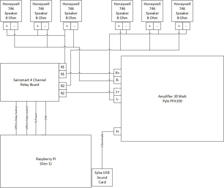

  3. When you talk about a relay board, which relays with which specifications? How did you wire everything up? A schematic would help me a lot to understand.
  4. Finally, if I got it right, your amplifier is connected to only one loudspeaker at a time depending on the relay which is switched? Or can you do announcement or play music everywhere at once? If not, how could this be accomplished? I guess it would make a big difference for the amplifier whether one, two or ten loudspeakers were connected to its output and that the volume would vary, right?

I’m currently using a cheap Pyle amplifier I ordered from Amazon (30 watts). No particular reason I chose it besides it was small and seemed like it had good reviews.
I’m using Honeywell/Ademco 746 alarm speakers for the system. I used generic 18 gauge speaker wire to connect the amp to the speakers through the relay.
For the relay, I used a generic SainSmart 4 channel relay board. This was readily available from Amazon and works at 5v. I’m attaching a diagram to this post.
It’s connected to groups of speakers, but also can be connected to all of them. I misspoke earlier saying they were all on the same stereo channel – When I went back and looked, I have each zone on a different stereo channel. The code allows for a specific zone to be turned on as well as both zones to be turned on. Yes, this would mean that there are different resistances on the line depending on how many zones are active. I’m not an audio guy either, but it doesn’t seem to impact the loudness/quality much, but using the different stereo channels may have something to do with that, as well as the channels being balanced.
