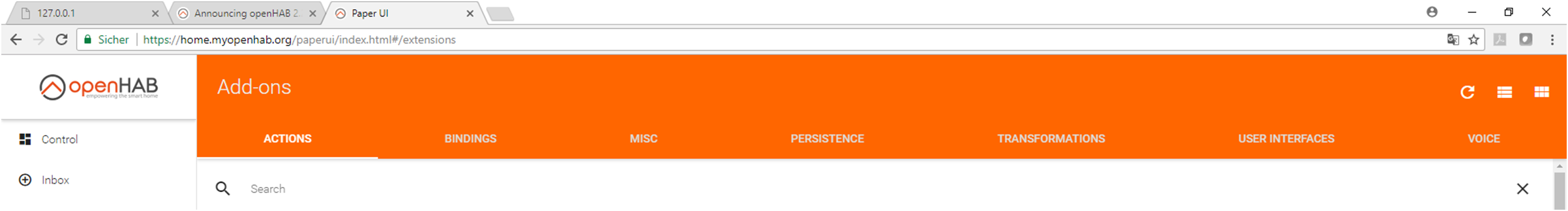

Thank you, I have updated yesterday openHab to 2.2.0 Release (Mac OS X) but in paperUi → add-ons → I have only 3 tabs: Bindings, Misc and Voice.
Hmm, I don’t know this issue, maybe there is a difference to Mac OS X version. (I use Windows 10)
Mine is looking (since a very long time) like this:
But you can also try:
