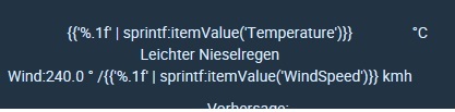

I’m using a weather widget (made by @kubawolanin) on habpanel, showing items like “Number:Temperature” results in a faulty display.
