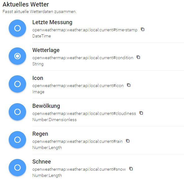

i can’t see the temperature as a condition in my current weather thing, using the newest .jar
Thats what i get:
Hi Joe, which OH2 version do you use? Latest snapshot?
i’m using openHAB 2.4.0 Build #1292
ok, i see. i need the 1316?
Yes, OH2 build 1316 or higher. But that should be no problem if you are already on snapshot.
thanks, it work’s :wink:
