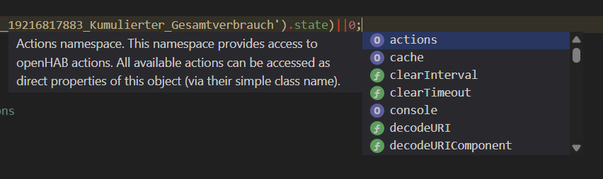

Hi, in the code editor, a dropdown menu now always appears when you type a space or end the command with ;.
I find the latter extremely annoying because when you want to press Enter to go to the next line after ;, it immediately takes action (entry above), even though you actually want to go to the next line.

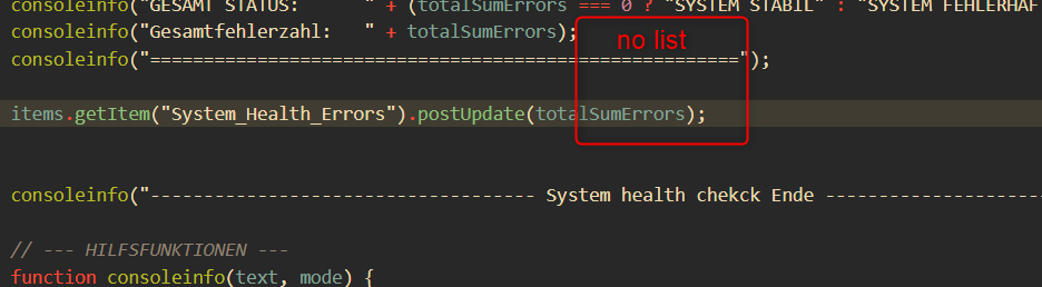

Ok, i made the changes in hint-javascript.ts by me and the new hint-javascript.test.ts as described Reduce unwanted JavaScript editor autocompletion in comments and outside code expressions. by jimtng · Pull Request #3975 · openhab/openhab-webui · GitHub , compile to org.openhab.ui-5.2.0-SNAPSHOT and tested it with my openhab 5.1.3..
All works fine!
