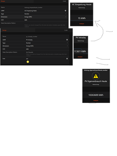

Hi all,
two ITEMs. pv_… and leistung_ … . Both between 0 an 40 (kWh).
What ist the correct way two calculate with them. This here is not working like it should:
val Number cba_3 = pv_intraday_number.state as Number - leistung_einspeiseheute_number.state as Number
Second question: any form of pv_… * 123.45 (value multiplied with a number) is not working either.
Maybe there is a helpful “how to calc in dsl rules” guide somewhere, to learn it from the scratch.
thx in advance
