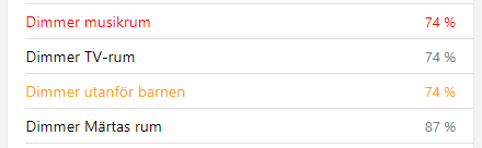

Another widget for battery level
Here’s another widget for displaying the battery levels for devices. It is a replacement for the standard oh-label-item with the following features:
  • Warn if the battery level is below a limit
  • Warn if the value has not been updated for a specific time
There are two configurable levels (warn - orange and error red) that can be set both on the battery level and the number of hours since the last update.
You need to have two items for the widget configuration; one for the actual device (with a battery level) and one for the time for the last update.
Inspiration came from Battery Status List, but I wanted a similar layout as oh-label-item as well as being warned if the device is not responding.
There is some info on how to get the time of last update (or change) here, Design Pattern: Time of Last Update
