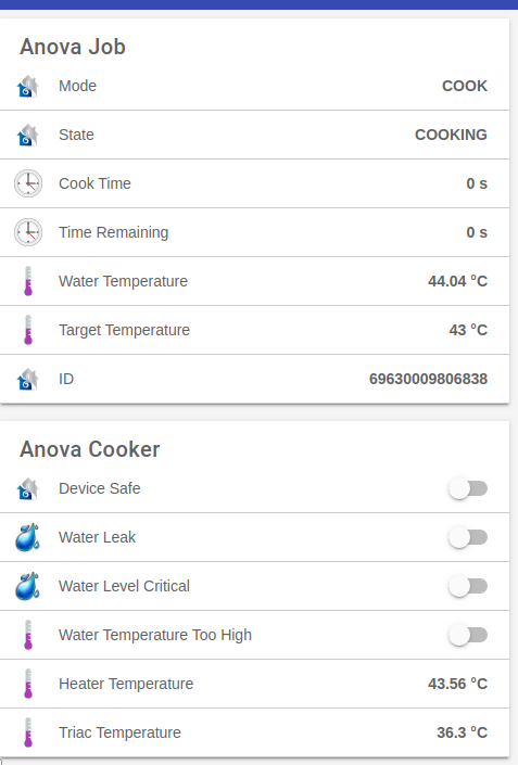

I gave it a first try. :wink:
The device is an ā€˜Anova Precision Cooker’ with bluetooth and WIFI.
And I’m running it on OH3, with JSON transformation.
Things to think about/improve?

My sitemap:
 Frame label="Anova Job" {
    Text item=anova_Mode
    Text item=anova_State
    Text item=anova_CookTimeSeconds
    Text item=anova_CookTimeRemaining
    Text item=anova_WaterTemp
    Text item=anova_TargetTemperature
    Text item=anova_Id
Frame label="Anova Cooker" {
    Switch item=anova_DeviceSafe
    Switch item=anova_WaterLeak
    Switch item=anova_WaterLevelCritical
    Switch item=anova_WaterTempTooHigh
    Text item=anova_HeaterTemp
    Text item=anova_TriacTemp
Feel free to improve/advice/… this.

         anova_WaterTempTooHigh.postUpdate       ((transform("JSONPATH","$[0].body.pin-info.water-temp-too-high", json)))
         anova_WaterTemp.postUpdate              (Double::parseDouble(transform("JSONPATH","$[0].body.temperature-info.water-temperature", json)))
         anova_HeaterTemp.postUpdate             (Double::parseDouble(transform("JSONPATH","$[0].body.temperature-info.heater-temperature", json)))
         anova_TriacTemp.postUpdate              (Double::parseDouble(transform("JSONPATH","$[0].body.temperature-info.triac-temperature", json)))
         anova_LastUpdate.postUpdate             ((transform("JSONPATH","$[0].header.created-at", json)))
         Thread::sleep(60000)
