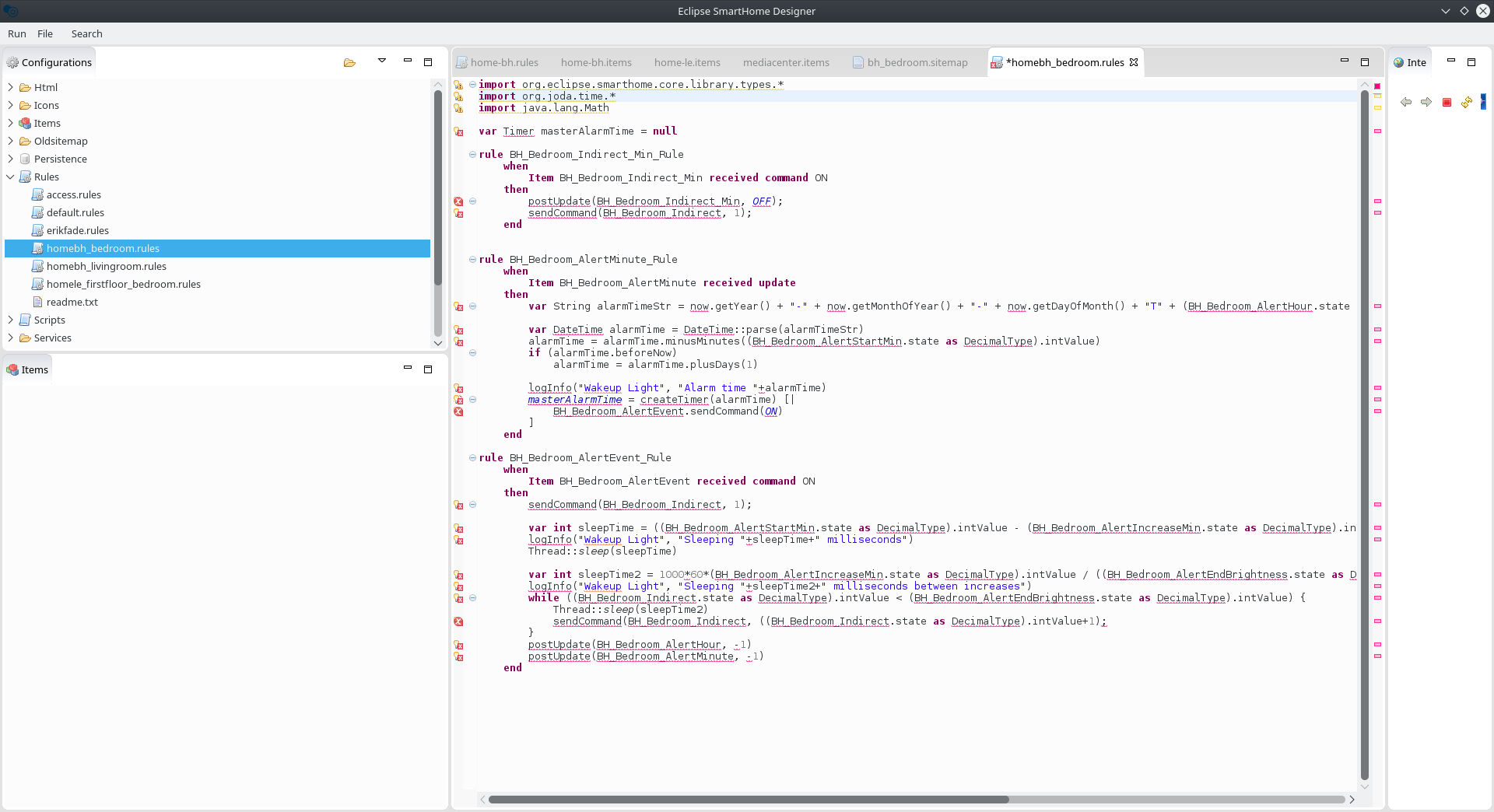

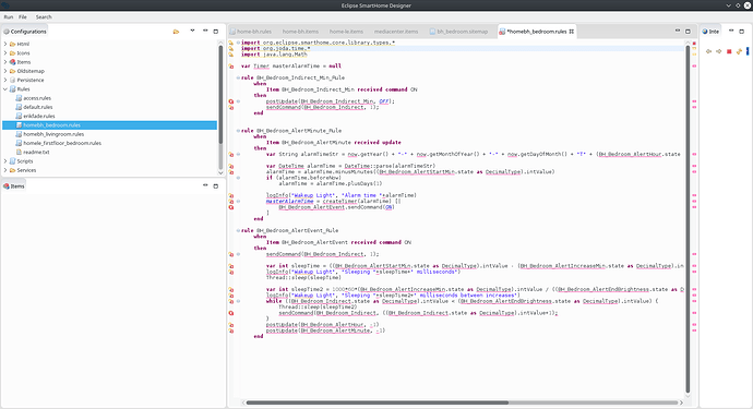

So I tried to fire up the SmarthomeDesigner, which I hate, (I like to just write that stuff in vim in an ssh session, like every other config on the server). Anyways, the OpenHABDesigner in OH1 was halfway useful to find issues. Unfortunately, it shows me this:
Apparently, even postUpdate() is allegedly undefined.
can anybody tell me if there is a way to develop rules that doesn’t make me want to electrocute myself with a zwave powerswitch?
Although I am not primarily looking for help on that particular ruleset, but on developing rules in general, here is the code for completeness (EDIT: The screenshot above is the WORKING code for the other room. Below is the adaption for the main bedroom)
