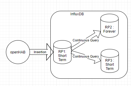

You can define multiple retention policies per database. See https://docs.influxdata.com/influxdb/v1/guides/downsample_and_retain/. And you can define the continuous queries so they only deal with certain data in that database. So I would expect OH to write to a “default” retention policy. Continuous queries would run to move the data that you care about (perhaps down sampled) to other fields that have your other retention policies applied.

Interesting thread, was wondering about the same thing. I’ll have to look up continuous queries to copy data items to other retention policies, looks promising.
As far as openHAB is concerned, it does not need to know about the different retention policies.
If you try to access a value for a persisted item you’ll either get a value or not, depending on where the continuous queries moved them (long- mid- or short-term).
