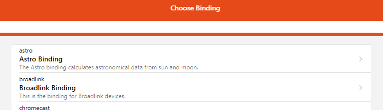

The add-ons folder is the correct place. Did you restart OH after doing that? I can’t remember if it’s necessary, but as soon as OH picks up the binding, you should see it when you try to manually add things.
However, the SP4s isn’t in the list of available devices. You might be able to get it to work with another SPx device in the list. If not, you’ll have to submit a request to @themillhousegroup to add it to the binding.

may i ask which folder is the correct addons folder?
/openhab/addons
/openhab/userdata/tmp/mvn/org/openhab/addons
i tried both mind you but most recently i tried openhab/addons and i restarted like you had recommended (which i had already done) on my second or third restart the jar file disappeared.
not sure where it went, but maybe that means it tried to install and got deleted, or installed and i just can’t find where?
I believe it should be /openhab/addons, but I’m a little out of my element here. I’m using the openHABian image, and the file system may not be quite the same in docker. I don’t know why the jar file would have disappeared, though.
I don’t think bindings show up in the log, but I’ve honestly never looked closely.
Ideally, this binding would get added to the Community Marketplace so that you can add it through MainUI, but that obviously hasn’t happened yet. Sorry I can’t be of more assistance.
