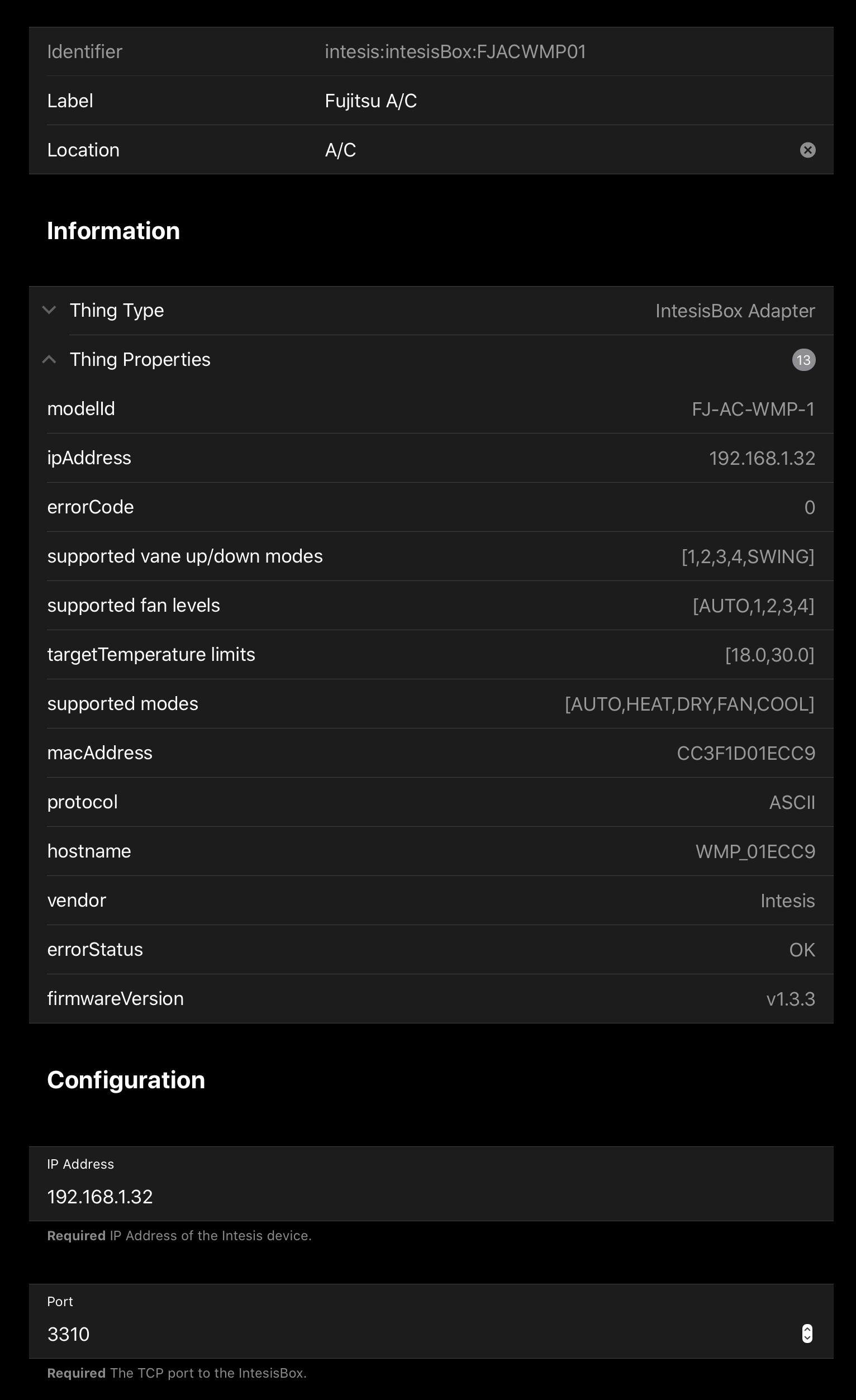

These are the properties:

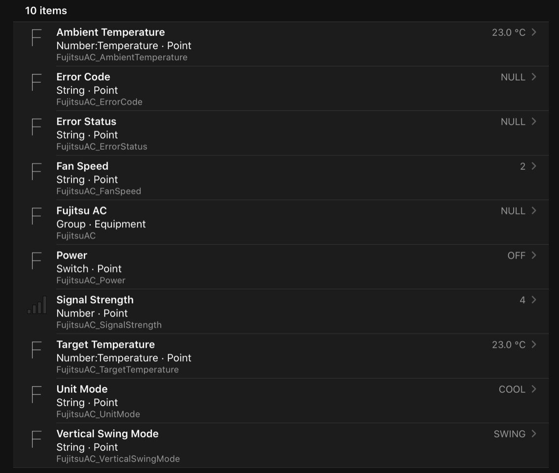

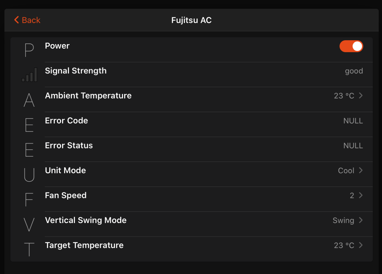

The only issue I had was in regards to the display of the Error Status, Error Code and Ambient Temperature, but this is most likely di to myself not having found the right README
The ambient temperature starts with the correct value then goes to null, the other two read-only values are always null (though they show correctly within the properties screen). Will have to study a bit more, in the meantime this is what it looks like.
Also need to learn how to configure/change the Target Temperature.
Note this is from a clean install no items file etc.
Will play some more later if I get more time.
Thanks, R.
Thanks for posting Rocky,
I will check later, as there seem to be something wrong, still seeing properties for eerorCode and errorstatus.
Will dive into it and come back later…

Figured thanks. Just updated to S1986, removed pages, items, things etc and re-created Intesis thing.
Target temperature is looking better but Error Status and Code are still null.
From memory they were channels in the original version of the binding but in the unified binding they became properties.
I suspect something went lost in translation and 3.0 has now Errors show as properties and channels.
Personally happy for them to be channels so the error status can be trapped programmatically i.e. to generate alerts… but no big deal.
Basically i suspect the ERR channels are not updated because they were no longer meant to be there, but… might be wrong.
Additionally seems we’ve lost the half degree on the Target Temperature, the 23.0 below should read 23.5
R.

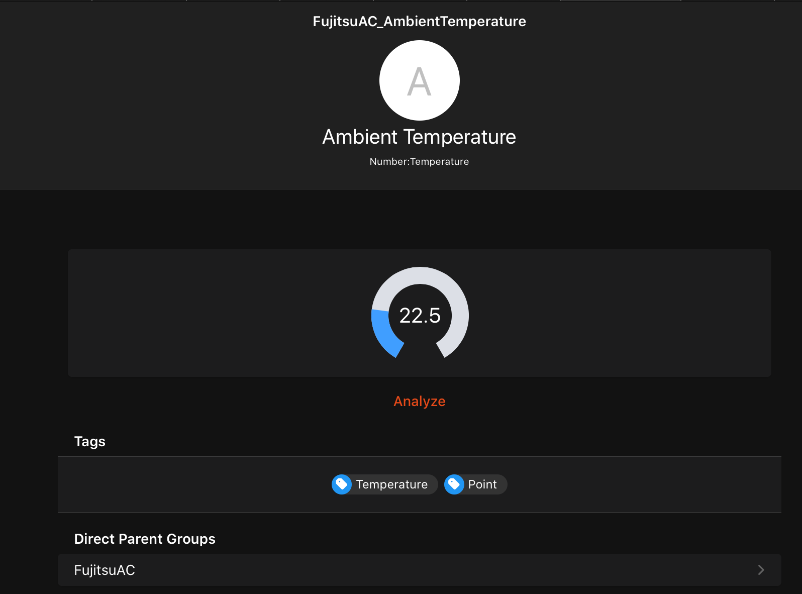

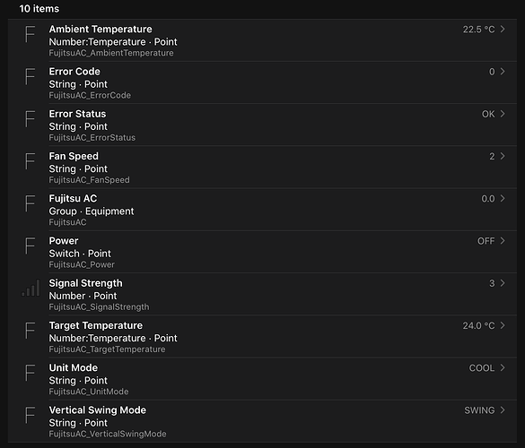

Build #1990 did it for me.
Error code and status come through correctly.
Ambient Temperature is now back to displaying Err, think due to default format of the auto generated item being incorrect. When format overridden (eg %.1f) in sitemap or State Description or anywhere else then displays correctly.
Strangely Target_Temperature never suffered from this formatting issue, maybe something to do with the attributes of the channel? In any case once format is set everything is looking good and behaving as expected. :+1: :+1:
Binding is fully functional, @hmerk thanks a lot! :beers:
Thanks for testing @rb44 :+1:
That’s strange, as I did not change anything on the ambientTemperature channel and as I understood, Build 1986 was showing up correct. I will check if I can optimize this.
Both channels are build with the same attributes.

It is indeed, best version yet. Used wizard to create Equipment, Items and Page Cells. All populated well formatted automatically including all lookups on Unit Mode, Fan Speed and Vane Swing Mode which is really great thanks!
Translated well to HABPanel also by using server provided format and item options.
