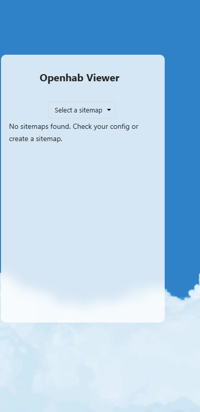

there is a nextcloud app that is supposed to show OH sitemaps, but I cannot get it to work.
the only configuration it has, is the address of the OH server instance.
the error I get is - cannot fetch sitemaps

i even tried setting a test sitemap via file in sitemaps folder, was thinking NC doesnt recognize sitemaps configured within MainUI, but nope. still same message..
ah it works.
I had disabled implicit security before, so I enforce authentication, but this nextcloud app cannot authenticate
edit: i re-enabled security (disabled implicit role) and configured nextcloud like this:
http://username:password@oh-ip:port
