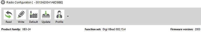

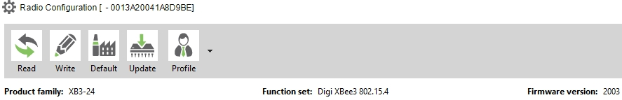

Meanwhile I also have a debug log for the Xbee stick:

No - that’s not what I meant - what I meant. There is an 802.15.4 version, a command mode version and another one that I forget. What one are you running?
vossivossi
(vossivossi)
October 4, 2020, 4:13pm
18
chris:
As far as I can see it in the XCTU display I would assume it is the 802.15.4 version:
Which version is supposed to work with the Zigbee binding?
Zigbee uses or is an enhancement of 802.15.4
