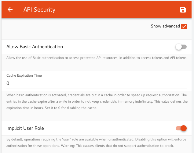

I’ve been with oh for a short time and I wonder what these settings are worth and how should I have them configured if I want to have the maximum possible security and also want to have different users (logged in) within oh.

OK, now this is something that can be addressed. The description for that last option addresses this. Turn it off and “disabling this option will enforce authorization.” So disable the Implicit User Role and nothing can access the REST API without authenticating.
Once authenticated, if that user has the admin role then that user has unfettered access to the entire REST API. If they have a users role that user can only access the Items end points (I think, maybe one or two other end points too).

I try to explain better, what I would like is to try that the REST API is not public for everyone that is within my network. That is, try to put some type of authentication (or what is possible / recommended) to restrict access to gets, puts, deletes …
The problem I get is that I don’t know why if I deactivate that option, all users and roles that I have (admins, users, other roles …) do not see the values in widgests or layouts …
I want those values to be seen but I would like to have deactivated that option that you are telling me (Implicit user role)

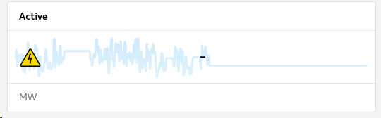

Regarding the widgets, they are the ones that I show in the image and they are the ones that openhab brings. They are within layouts that I have created and not on the main page as such. As I mentioned above, I would like the values to be displayed with the implicit user role option disabled.

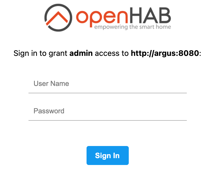

Walk us through exactly how you are logging in to OH and what the settings are. Assuming Basic Auth is turned off and Implicit User Role is turned off navigate http://<address of openHAB>:8080. All you should be able to do or see is login. Nothing else should be displayed.
Without logging in now try to load http://<address of openHAB>:8080/developer/api-explorer. Nothing should be displayed.
Now log in as a user with an admin role. You should now have access to everything. Log out and log in with a user with the users role (there are only two roles). The administrative parts of the page should not be there and if you try to access them with a direct URL it will not show anything.
That widget is showing some data though. It shows that the REST API for persistence queries is working or else it wouldn’t be able to generate that trend line. And that trend line indicates it’s been awhile since that Item has updated. That shows that something is working. If you are certain that those Items have values (look in events.log) then there might be a bug with the SSE feed or the like.

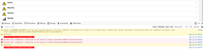

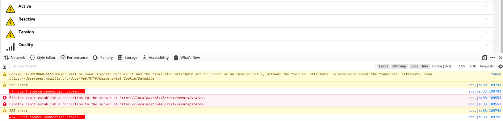

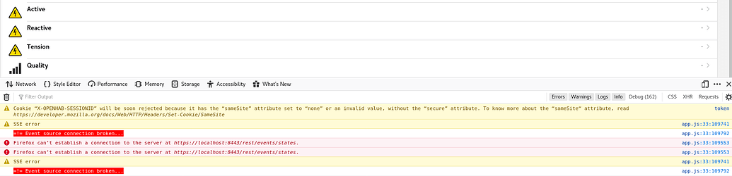

When I disable the implicit user option. My values do not arrive. In the Event Monitor I do not receive anything (but in the events.log yes…the data), it may be an SSE problem that you mention but I have no idea what this is or what may have caused it. What I do to make it fail is uncheck the implicit user option, if I leave it activated it works and the values are shown.
