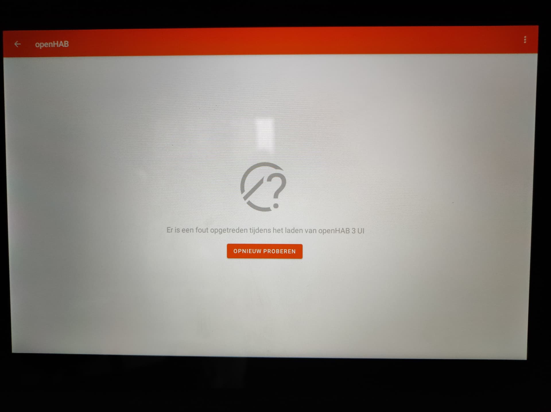

Took a long time for spontaneous appearing, so today I forced it by dis/enabling the wifi. In Dutch it says “An error occured while loading openhab 3 UI” with a reconnect button. But … wait for it … I upgraded today to the new 3.3 version. And this changes the behavior, in about a minute (after the wifi was back) it actually reconnects to the server again (instead of switching to a complete white screen). So apparently something in this release fixed my problem!!!
