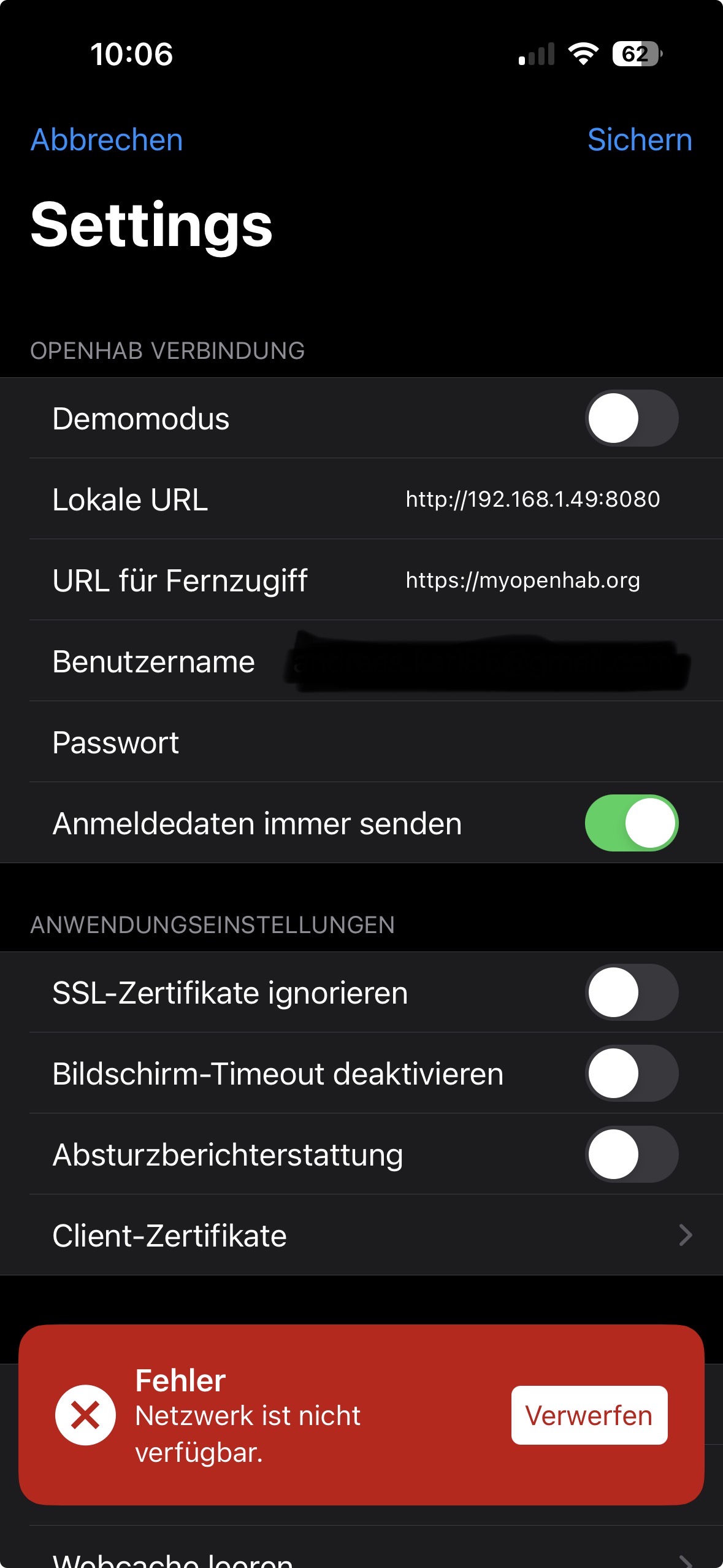

OpenHab V1 shows: network not available
OpenHab shows: no connection
Browser working flawless
All pointing to 192.168.1.49:8080
On wife’s iOS OpenHab V1 it’s working. And if I restart OH over console I can connect again also with my phone, but behavior returns after 2 days. What’s going on here?

Please post a screenshot of your apps complete Settings
iPhone X on 16.7 works
iPhone 15 on 26.3 not working
iPhone 14 on 26.3 works
Difference I can see is „Allways send credentials“ which i have disabled.
Also I have „ Ignore SSL …“ enabled.
