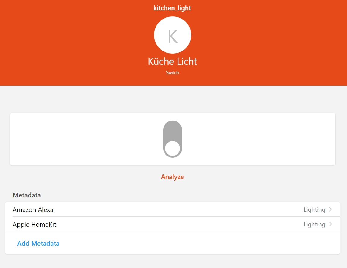

yes, sure. just add homekit metadata to the item.
e.g. i use alexa and homekit. looks like this
Yup, definitely. You can use any or all of homekit, google home and alexa if you choose, using the metadata setup posted above. For example I use multiple echos/alexas as voice agents in the house and garage. Homekit is configured as well to allow me to get reliable presence status and also to show status updates in carplay like when the garage door opens and closes.
