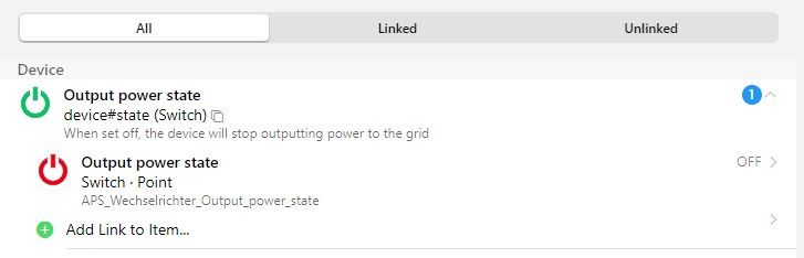

However, the Output Power State always remains OFF.
Thank you for the hint. A wrong key was set when parsing the response. I renamed state to status to better reflect the API responses. Should work now.
You need to unlink the item and link against the renamed channel “device#status”.

The previous status channel has disappeared, but the new one does not appear.

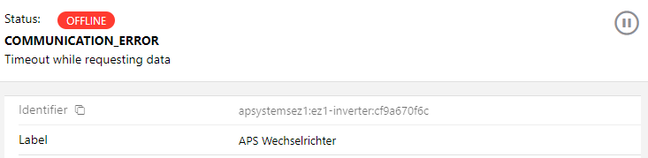

Wouldn’t it make sense to set the thing status to offline when the device status is off? Comm error is a bit confusing.
I think, because I changed the thing definition, you have to recreate the Thing to make the channel appear. Watch out to link your items after recreating the Thing. Sorry.
The Thing is offline with “communication error” as status detail because I can’t deduce the reason why the inverter is not reachable.
Problem: The inverter (EZ1-M in my case) is not powered from the grid but from the solar panels and shuts down if there is not enough power. → No Bluetooth and no Wifi on rainy days or after sunset.
If the inverter is not available in the network we get a communication error. But the binding does not know why the inverter is not available. Could be different things like wrong IP/Hostname, wrong port, your openHAB instance can’t access the network, inverter offline and so on. For the request executed it‘s a communication error in any of those cases.

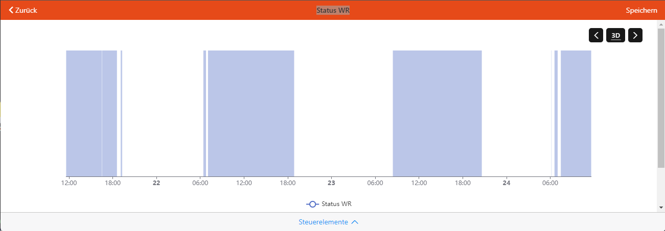

So far I have gotten the data from the inverter via Rule. I could see that before the inverter switches off, the status changes to OFF. Now you could use the thing status from the inverter status “OFF” and the occurring timeout for OFFLINE. If only the timeout comes and the status is ON, then it is a communication problem. If there is no timeout and the status is OFF, then the thing is ONLINE. What do you make of it?

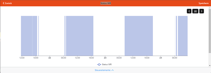

Attached are the last 3 days of the inverter status from me (read out by rule). You can see ON and OFF, which could confirm my thesis. I didn’t send any commands to the status, which is something you could do.
I wasn’t aware that the inverter sets its status to OFF on its own. This isn’t mentioned in the API description. As long as the behavior is not clearly described, I don’t think it’s a good idea to use the status for other purposes.
So your suggestion is that if the inverter sets its status to OFF and shortly after becomes unreachable, we set the Thing’s status to OFFLINE (without COMMUNICATION_ERROR)? And in all other cases set the status of the THING to OFFLINE (with COMMUNICATION_ERROR)?
Exactly.
Status OFF & TimeOut → Thing OFFLINE
Status ON & TimeOut → Thing communication error
Status ON & no TimeOut → Thing ONLINE
Status OFF & no TimeOut → Thing ONLINE

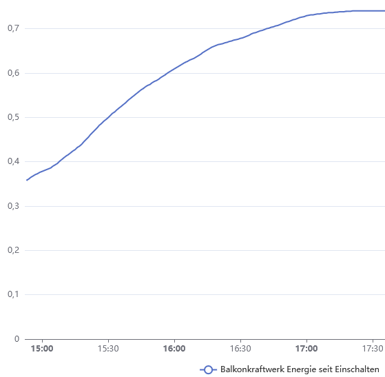

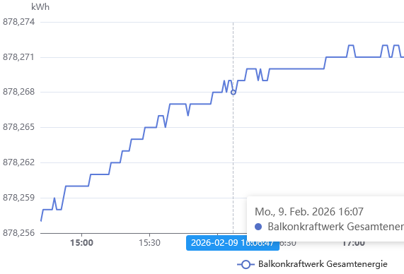

Using the patched jar file for openHAB 5.1 from above, I observe a strange issue which I had not noticed using the “original” binding in openHAB 4.3:
There are significant discrepancies between “Energy Lifetime” and “Energy since startup”: Every day, “Energy Lifetime” reports significantly less energy for the day than “Energy since startup”.
Additionally, “Energy Lifetime” has non-monotonic growth. For example today’s measurements:
vs. “Energy since startup”:
Total energy today, according to “Energy Lifetime”: 24 Wh
Total energy today, according to “Energy since startup”: 740 Wh
I have not observed this in openHAB4, using the JAR file from the Marketplace. Can anybody confirm this behavior or does it work correctly for you?
