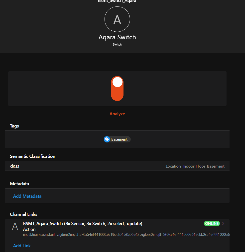

Thanks Rich - it got me pretty much in the right direction, I did have to enable legacy options as in screen shot, then the SCAN worked and found the switch.
From that I chose the option to create a thing, and it did.
From the thing I chose to create an Item which it did.
But its making fun of me and not working.
