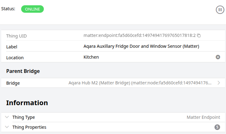

Yep, this is how it works for me. I have an old Aqara M2 hub and as soon as a device is added to the hub, that device becomes available in OH. In the matter binding terminology, the hub is added as a matter node and becomes a bridge for all of its devices (any device connected to that hub is added to OH as a matter endpoint).
This is a little different than some of the other matter systems where the you add the device to a Matter Controller’s matter network (fabric) and then the Controller will give you the option to also connect the device in OH’s matter fabric as it’s own node. In that situation, you don’t even need the first controller anymore after the device is connected in OH’s matter fabric, that connection is direct.
