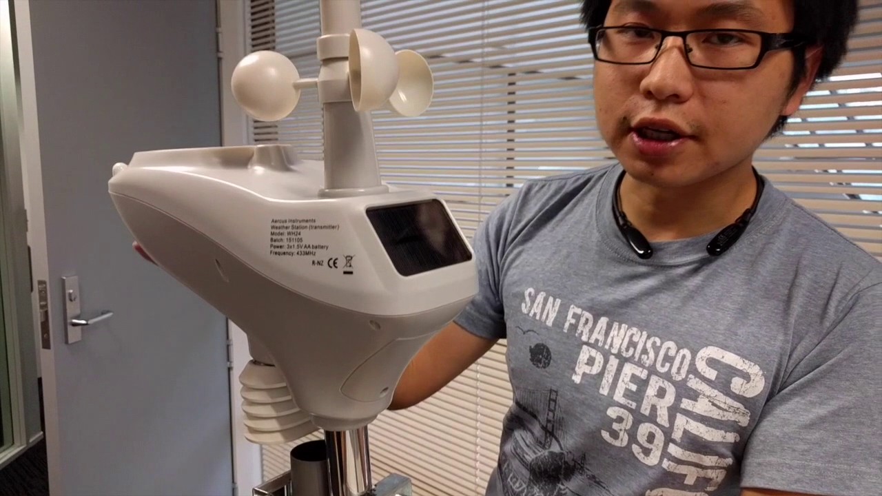

It has the same “green” rechargeable batteries like this guy in the video below. (at ~3mins)
these are special batts at 1,5v labeled with “Rechargeable Alkaline”. If you need to replace them other people suggest NiZN batts instead of regular NiCd NiMh

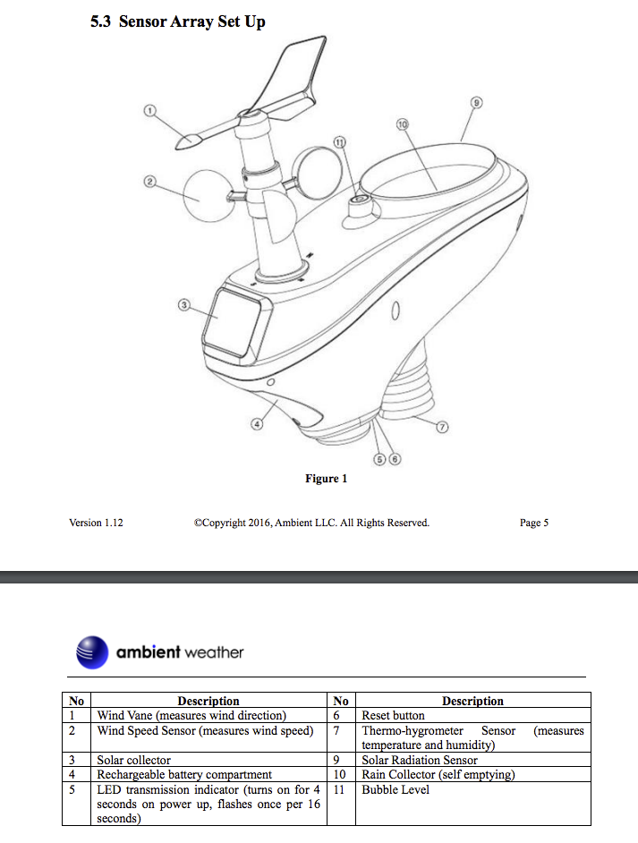

Not sure if theres a difference - someone else claimed the WH2601 is the same as the AW1400 which I have - but there is a solar radiation sensor (see (9) ):
Manual here: http://site.ambientweatherstore.com/Manuals/ws1400ip.pdf
Cheers,
-Th
I guess, they are indeed the same - the WH2601 also has an UV-sensor.

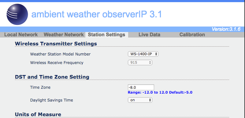

Thanks for sharing. It is worth noting, that despite there’s no need for a cloud account or a wunderground integration, you should configure the station for wunderground integration - that seems to be the only way, the station gets an time update.
Without wunderground integration, the station is timeless it seems.
Hmm, interesting, never used it w/o WU, but there are setting for Timezone and DST, which led me to believe that it got time via NTP:
At the end of the day, the thing is useless w/o a WU account or some other form of storage/presentation. The internal web page is close to useless. Thus, this thing isn’t much more than a bunch of sensors accessible via the network. Time only enters the picture if that info gets stored somewhere.

Which other weather stations can you choose in the first field of the screenshot?
Is the IP-Indoor-Station compatible with other weatherstations, too?

The only other option is WS-1200-IP. Don’t think it’s compatible with any other types of stations, AFAIK it’s a proprietary RF protocol how it talks to the outside sensor array.
-Th
