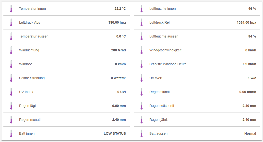

I just installed it THIS weekend… So I just put all the values on a temp sitemap …
not pretty or done anything with it yet… but it works pretty good and you can have a look at ALL possible values

Looks quite nice! Do you know the difference to the WH3000? I don’t find a comparison and they seem to be the same?
Wh3000 seems Cloud only.
No local Webserver.
Still possible but not in an offline Mode.
Wh2600 can do offline and weather Underground (optional)

EDIT: Your indoor battery shows already low, even tho you’re saying yu just installed it. Don’t worry, seems like it’s always showing that - mine did for the last 2 years and it still works…
I Grab it from the local Page with http Binding and regex.
The Indoor Module Shows Low because i use eneloops and it is designed for non rechargeable batts (1,2 vs 1,5 volts)
