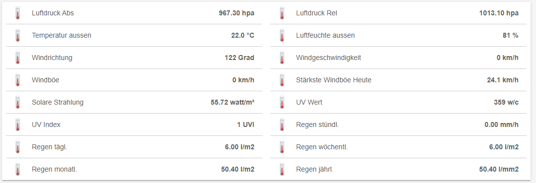

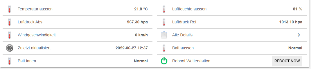

Thats how it looks when I unboxed it:
And added to OH:
