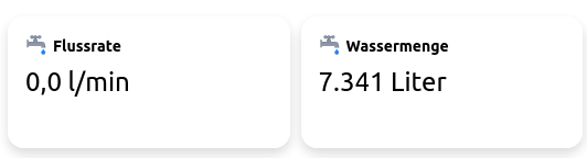

I’d like to format a number (total amount of water in liters) in Main UI as 7.301 Liter (as in: 7 thousand 145 liter). Currently it’s shown as 7,301 Liter.
I’m using a stateDescription to format it (currently: %, .0f Liter). Changing it to %. .0f Liter instead results in gibberish.

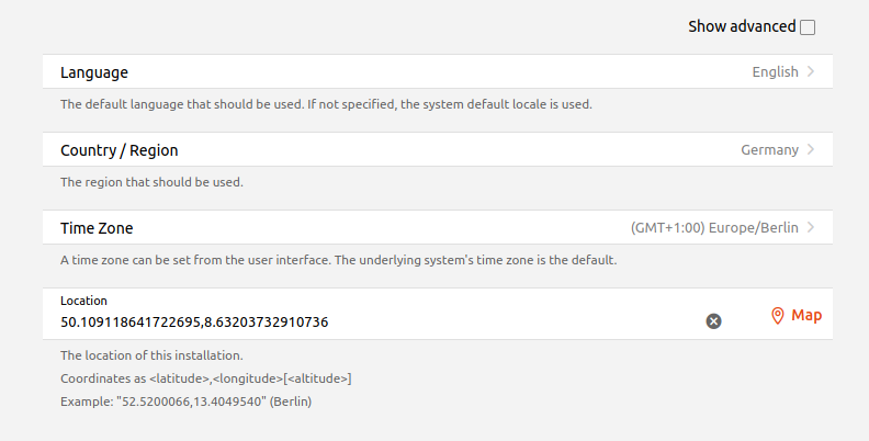

Changing the openHAB Regional Setting to “German” (though I’d like to have openHAB in English) doesn’t make a difference.

  2. In my openHAB "Regional Settings, the measurement system is set to “metric” and language is “English” → Ok from what I can see.

Thanks for all the hints. I managed to solve the problem myself based on the hints above.
Fun fact: My case illustrates how important it is to state the overall setting in which you’re operating in when opening a new post here in this forum: Since I’m running on docker (but forgot to mention this), raspi-config doesn’t even play a role, since this changes the Raspbian-variables, and the ones that are relevant for openHAB are (in my case) the ones of the docker container and thus defined in my docker-compose.yml. As a result the problem is also fairly easy to fix.
