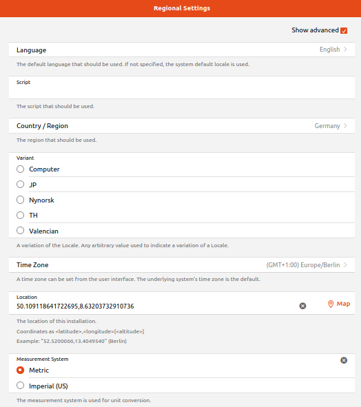

So just to double-check, to not mess up the wrong parameter, before I keep messing around with internals:
  1. My raspi-config is set to the profile de_DE.UTF-8 → Ok from what I can see.
  2. In my openHAB "Regional Settings, the measurement system is set to “metric” and language is “English” → Ok from what I can see.
  3. In the karaf-console, as mentioned here, the reading user.country is the one I have to change as described in the post, if I want to keep openHAB’s language as “English” and the number formating with “.” as thousand separator. Correct?
