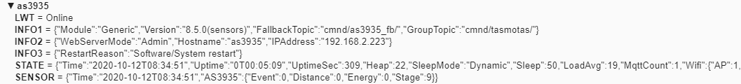

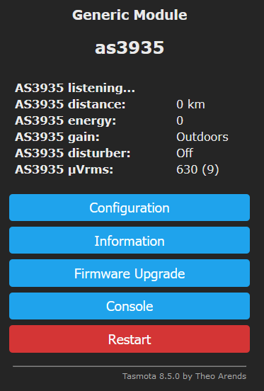

I implemented the project with the AS3935 lightning sensor and now wanted to know what the names of the things and items that come from Tasmota during a thunderstorm are called. Without a thunderstorm I don’t see this data in the MQTT.

22:17:43 MQT: stat/sonoff/RESULT = {"AS3935":{"Gain":"Outdoors","NFfloor":1,"uVrms":630,"Tunecaps":15,"MinNumLight":1,"Rejektion":5,"Wdthreshold":2,"MinNFstage":6,"NFAutoTime":4,"DisturberAutoTime":1,"Disturber":"On","NFauto":"Off","Disturberauto":"On","NFautomax":"On","Mqttlightevent":"On"}}
You can also poll mqtt explorer or the tasmota tasmota console it will show the topics being published.
here the values from the sensor are missing

Errorlog:
2020-10-12 09:44:51.190 [WARN ] [t.generic.ChannelStateTransformation] - Executing the JSONPATH-transformation failed: Invalid path '$.AS3935.uVrms' in '{"Time":"2020-10-12T08:44:51","AS3935":{"Event":0,"Distance":0,"Energy":0,"Stage":9}}'
2020-10-12 09:44:51.207 [WARN ] [t.generic.ChannelStateTransformation] - Executing the JSONPATH-transformation failed: Invalid path '$.AS3935.Disturber' in '{"Time":"2020-10-12T08:44:51","AS3935":{"Event":0,"Distance":0,"Energy":0,"Stage":9}}'
2020-10-12 09:44:51.212 [WARN ] [t.generic.ChannelStateTransformation] - Executing the JSONPATH-transformation failed: Invalid path '$.AS3935.NFfloor' in '{"Time":"2020-10-12T08:44:51","AS3935":{"Event":0,"Distance":0,"Energy":0,"Stage":9}}'
2020-10-12 09:44:51.217 [WARN ] [t.generic.ChannelStateTransformation] - Executing the JSONPATH-transformation failed: Invalid path '$.AS3935.Gain' in '{"Time":"2020-10-12T08:44:51","AS3935":{"Event":0,"Distance":0,"Energy":0,"Stage":9}}'
