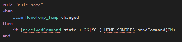

Ask for a solution
I want the fan to turn on at 26 degrees.
(sonoff3 is the fan name)

#12 says to use code fences You are not going to get many people squinting at a screenshot.

Pain in ass to copy past click on the image then copy paste your code inbetween and you will get
rule "rule name"
    Item HomeTemp_Temp changed
    if (receivedCommand.state > 26|°C ) HOME_SONOFF3.sendCommand(ON)

This isn’t going to work, there is no command when this rule is triggered.
The Item appears to be just a Number type, not a Number:Temperature, so there should be no units involved here.
rule "my rule name"
    logInfo("test", "House temp Changed to " + HomeTemp_Temp.state)
    if (HomeTemp_Temp.state > 26) {
        logInfo("Fan", "Turned on")
    } else {
        logInfo("test", "House temp not more than 26")
and look in your openhab.log
Rules can be a bit a bit funny about treating states as numbers, you may need to spell it out
if (HomeTemp_Temp.state as Number > 26) {

Thank you very much, the code you wrote works. :tada: :tada: :tada:
