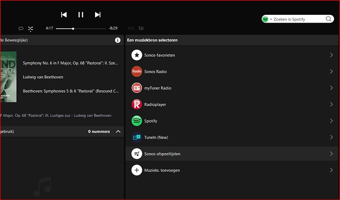

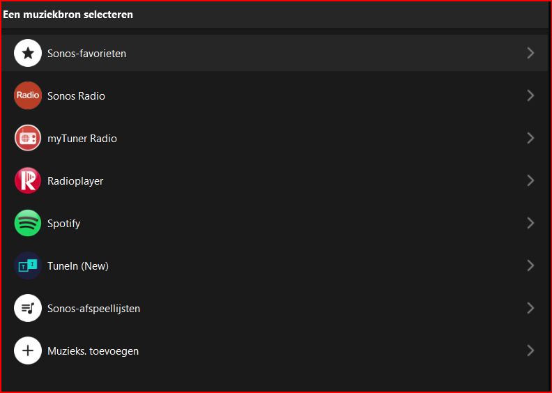

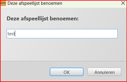

In the (Windows) Sonos app, I “added” a playlist “to Sonos playlist”:

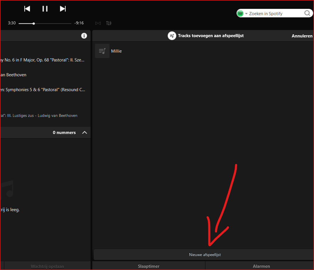

The next window is a bit confusing, but you need to click “New playlist”:
This opens up a pop-up, in which you name your new playlist:

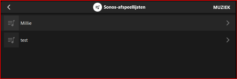

Now, this playlist is visible here:
See:
I have a playlist, which (in a JavaScript rule) I can start with:
items.getItem("Sonos_de_Beweeglijke_Playlist").sendCommand("Millie")

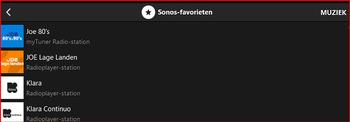

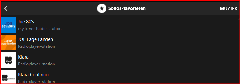

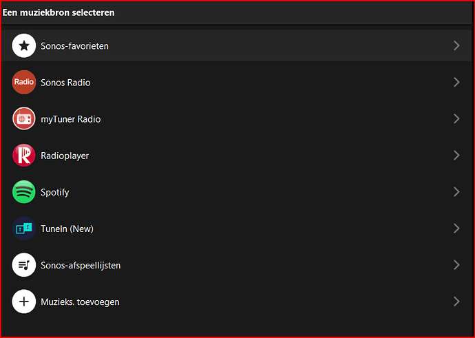

So for radio channels, I expected channel Radio to do the trick, but I must not have configured my favorite radio channels “correctly”. But considering my radio channels are all located in “Sonos favorites”:
Apparently, I can rename these “favorites”. But let’s use a simple one: “Klara”.
I tried channel Favorite, and this JavaScript code:
items["Sonos_de_Beweeglijke_Favorite"].sendCommand("Klara")
And it works!

Playing Sonos Favorites and Sonos Playlists works as you described. I need to define either a Sonos Favorite or a Sonos Playlist for everything that I want to stream and it seems to cover all my needs actually! So. thanks a lot!
Thinking about this afterwards, I assume just using the ‘Favorite’ route would also work for playlists… That way, you would not need to add a playlist.
But I haven’t tested that. I just discovered that way yesterday myself :slight_smile:
Thanks, @ErikDB!
I’m currently testing that out. In Sonos Favorites, I have a TIDAL playlist, and it seems to be working well, it’s a great playlist, by the way. In Sonos Playlists, I’ve saved all the songs from the TIDAL playlist. Keeping it as a Favorite has the advantage of automatically updating whenever TIDAL updates the playlist, unlike the static version in Sonos Playlists.
